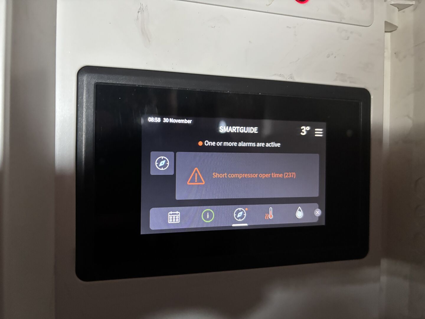

Hi. I won’t go into the background of my heat pump installation and everything that was wrong with it. The installers are no longer in business. A report suggests our heat pump is not big enough for the house. Every time it gets below 2 degrees it faults and we get the following alarm message. Any idea what this is and how we might fix it? It is something about the short compressor…. Thanks!

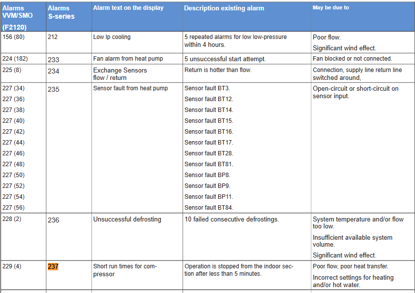

There isnt a short compressor, its that the operating time of the compressor is too short. According to google it may be due to low refrigerant level or component malfunction (the other reason for compressor operating time too short is short cycling - but at 2C thats unlikley).
If Google is correct you will need a Nibe repair man

It could alternatively be to do with the downstream system (your radiators/UFH). What do you have, do you have zone valves, TRVs or room thermostats, if so how are those set? Does this ONLY happen when its 2C or below

If it happens only when it gets cold then it maybe that the heat pump tries to increase flow rate at lower outside temps/higher flow temps, and fails due to too much resistance. This could be as simple as a filter blocking up which is unfortunately a maintenance item, probably roughly annually. Why don't you find out what he does.
