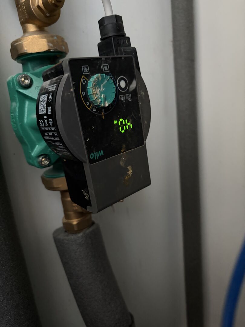

Hello,
I have a Samsung heat pump, within the water take closer we have it has a Pico circulating pump, but this appears to run all the time, there is constant noise from the closet and the screen of the pump says “40w” which I assume means it is consuming 40w of energy, is this normal to be on all the time?

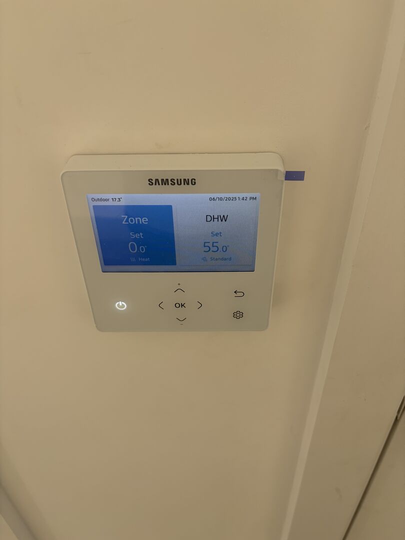

(@lch07)
Posts: 13
@pirate-rich
IMG 8058
IMG 8055
Picture above of the central control panel and the pump that is constantly running

Where is the white box (that says Samsung on it, not the heat pump lol). Wide angle shots of the heating equipment internally would be good too.

(@lch07)
Posts: 13
Worth adding that the board under the metal Samsung panel was replaced to fix another issue, so could be that they haven’t put something back correctly?
