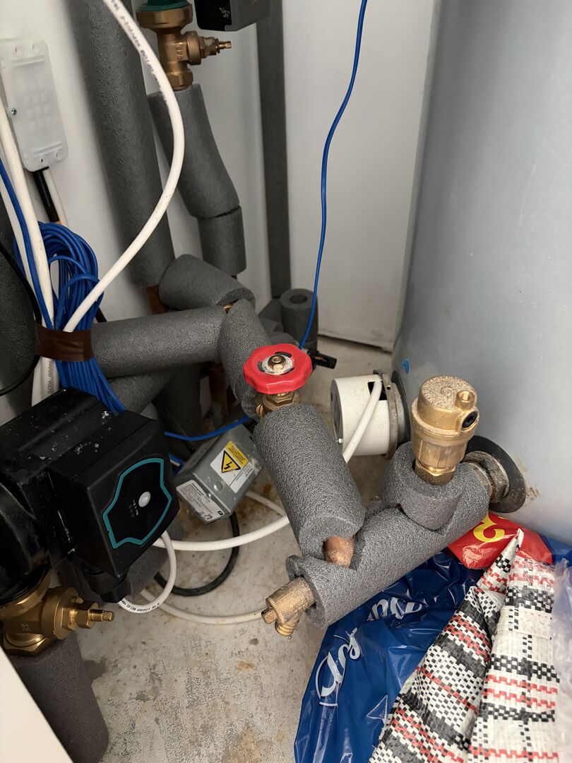

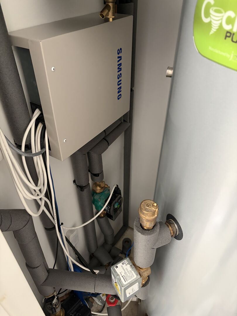

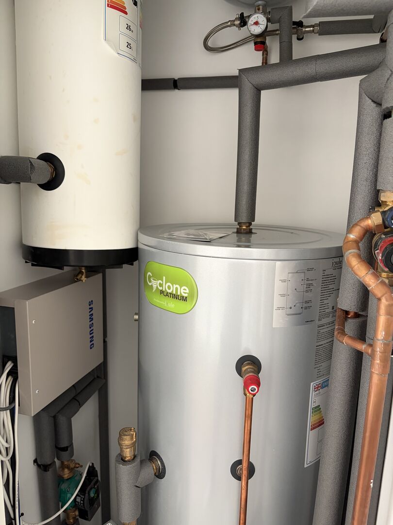

Can I have some good pictures of the bottom of this cupboard and the equipment down there please.

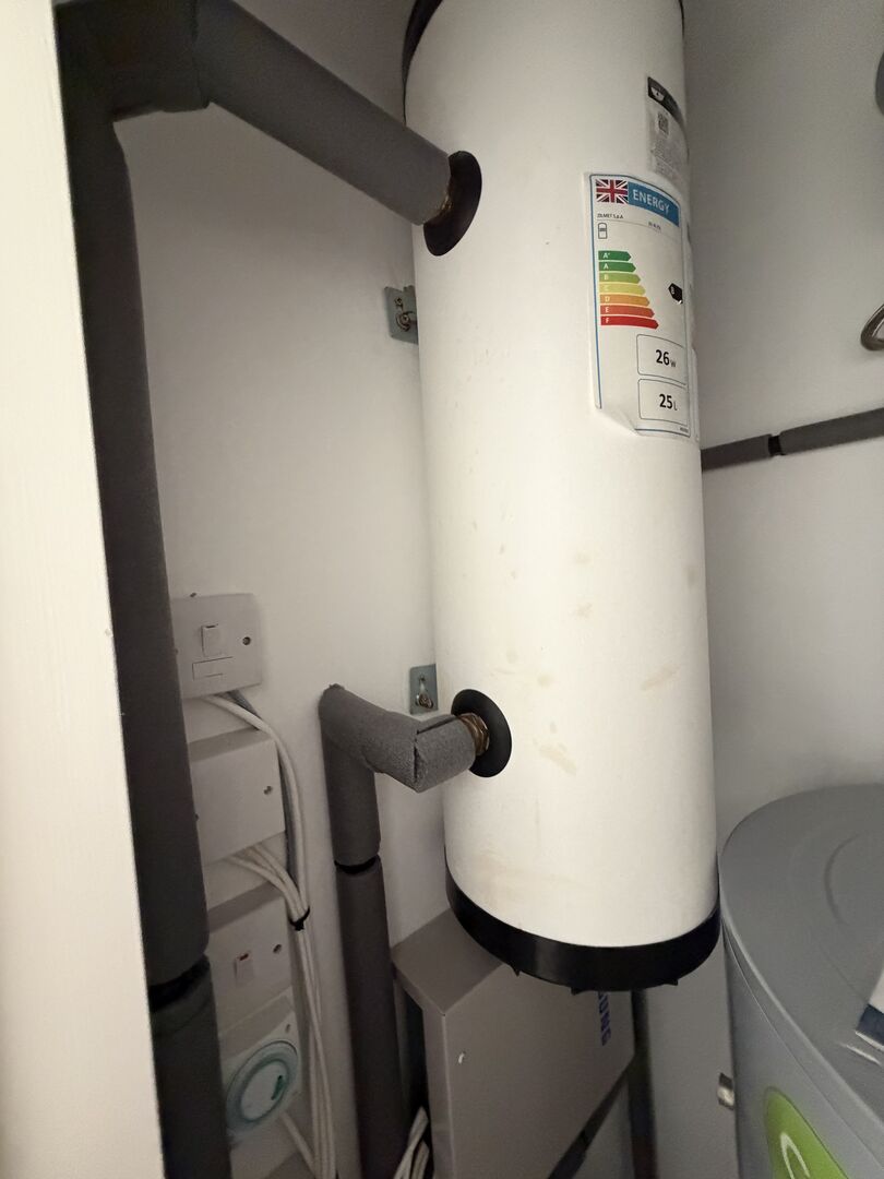

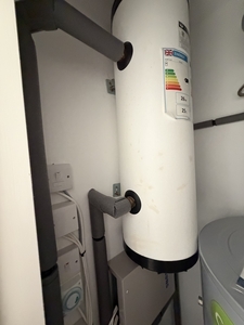

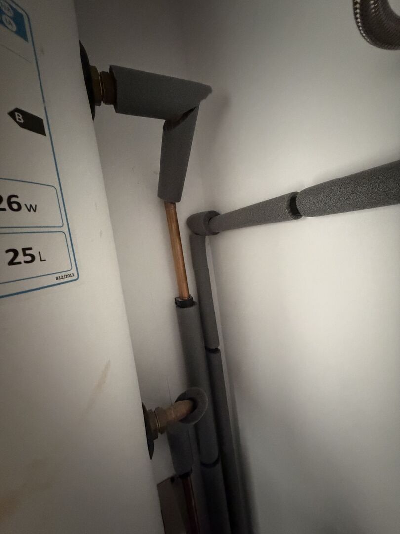

Posts: 31
Posted by: @lch07
IMG 8060
@pirate-rich
Also on that white buffer cylinder are there 2 or 4 pipes coming out of it? Pics would be good to clarify.

(@lch07)
Posts: 13
@old_scientist hey!
2091 is set to Use (Signal on/off) or WL interlink Off (waterpump3)
2092 is set to Not Use
2093 is set to the same as 91
(@lch07)
Posts: 13
@pirate-rich
IMG 8061
IMG 8062
IMG 8063
Hopefully these help. Looks like 4 pipes, 2 on each side

Pirate Rich
(@pirate-rich)
Posts: 31
Posted by: @lch07
@pirate-rich
IMG 8061
IMG 8062
IMG 8063
So, you actually have two pumps, not one. @old_scientist is going in the right direction with you. If you run out of ideas I'm here in the background. 🏴‍☠️👍

(@old_scientist)
Prominent Member Member
Posts: 575
Looks like you have a 25L buffer vessel, so I'm guessing there are two pumps, one on the primary side of the buffer, and one on the secondary side.
As per my previous post, I'd suggest changing #2091 and #2093 and observing the effect on pump function when the heat pump switches off. They should either run for 1min and stop, run continuously, or run 7min off/3min on depending on the setting.
