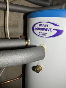

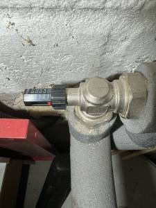

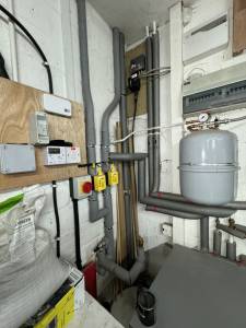

Hello all wondering if it is possible to add monitoring to my heat pump? Was installed a few years ago by Greener Energy and to be honest the performance has been crap. All the radiators were changed along with the hot water cylinder.
Things I notice are struggling to get inside temps above 19c without it running full bore all the time also if heat is not on notice the rads get warm when calling for hot water. Checked the CH zone valance and that’s ok so figure the piping is not correct.
Also wanting to get rid of the Tado controller and use just the grant controller as from what I have seen on here that is the way to go for best efficiency. Problem is they installed that in the room above the garage which isn’t heated so would need moved presumably.
Any help or advice is greatly appreciated! I can also try and get some pictures of the piping setup if that helps.

@derek-m Just a thought; if the hot water is still flowing into the radiator circuit when supposedly on DHW, may be worth checking the 3 way valve as it might be stuck partly open. Were this the case, it would restrict the CH flow and prevent full heat reaching the radiators / emitters - just a thought. Regards, Toodles.

Toodles, first thing I checked was the zone valves. They seem to be working fine. Think the issue may be with the return or maybe I should have a second zone valve on the heating circuit. Going to have a good look at the piping next week.

Looking at your sketches, I cannot see any particular problem with the pipework arrangement.
When you say that the radiators are getting warm when the system is in DHW mode, is that all the radiators or just selected ones? Check that the flow through the electrically operated valves is in the correct direction.
If you cannot achieve the desired indoor temperature during cold weather, at what outside temperature does this occur? What are the heat loss calculations for your home?

Does your circuit include a visual flow gauge and flow setter? Grant include in their more recent literature, but it may not have been recommended/required a few years ago.
If it has, what flow rate does it indicate for CH and HW generation? Expect the HW flow to be higher than in CH as it is a much less restrictive piping system.
You have no second circulating pump from your pictures & diagrams, just the one inside the Grant unit? Is it on maximum flow setting? It likely has 3 speeds? Refer Grant installation literature and check the PCB dip switch settings inside the Aerona unit.
How many radiators on your CH circuit and what typical pipework size? Is it usual retrofit of 15mm pipes into rads off 22mm flow and return piping? Or have you any smaller bore pipework, extensive use of plastic rather than copper?
