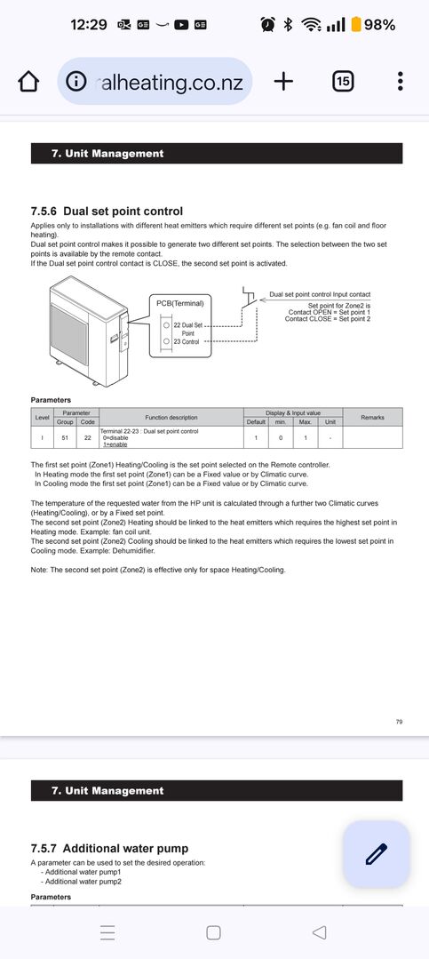

Am I right in thinking the second set point is configured using the zone 2 settings?
Yes, but if you don't have zone valves etc, heat pump just ramps up and down temp as required to the single zone. I use the same input on mine to ramp up during excess PV.
Screenshot 2025 05 14 12 29 27 04 40deb401b9ffe8e1df2f1cc5ba480b12
Got you I will look at implementing this cheers!
