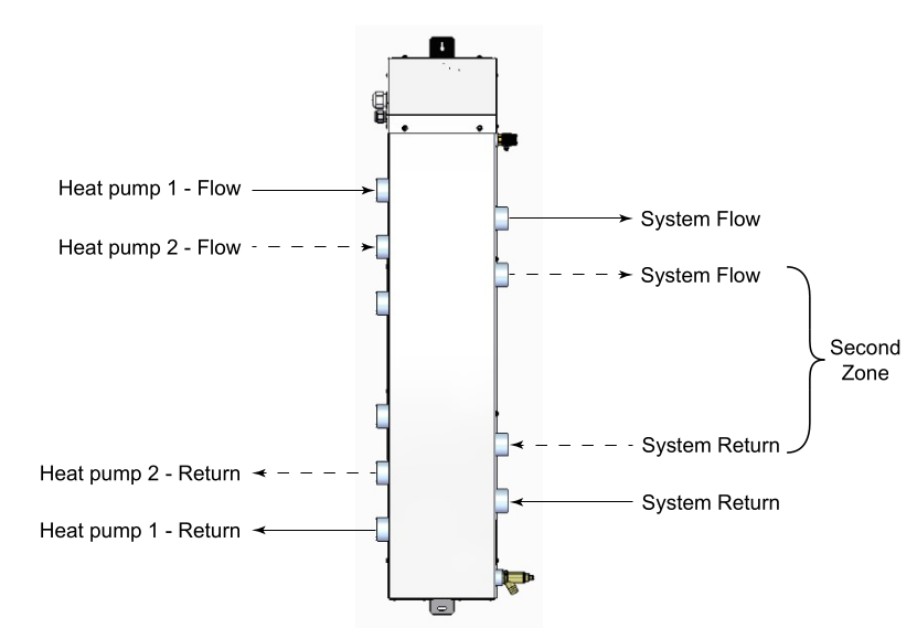

That the specialist comes, caps the top 2 ports, runs the flow pipe to the pipe to the heating direct around the top of the 50L buffer, removes the secondary pump.  Changes some settings.
Installs a new Grant panel, that's smart, not some 80s-90s style keycombo driven installer settings nonsense with code lookup to change settings.
Installs a digital flow setter.

Am pushing for the 2 port conversion, no LLH on flow, 50L LLH becomes volumiser on return. And the new smart Grant panel plus a digital flow setter, and obviously secondary pump removed.

One thing that's made my head hurt more than usual is trying to figure out how a zoned building can be supported. I don't really see how a Grant (with essentially fixed flow rate from the HP and the "recommended" LLH) can work correctly in a zoned house, even if you have 2 identical zones you still have 3 modes of space heating - zone 1, zone 2, or both. I find that my zone 2 (upstairs ... in a dormer bungalow) is totally overpowered by the HP when only it is being heated, because the flow rate is much too high, and there's nothing in the Grant set-up to support a PWM signal to the circulation pump, nor anything to suggest this idea in the Installation Guide.
As pointed out, the Installation Guide really highlights how little Grant seem to understand about the (Chofu) unit they sell (and are still selling I think). Ironically the Installation Guide for their LLH seems to make more sense, and they even suggest a better way of handling a 2 zone set-up:
- by using 2 feeds out of the LLH you could have separate secondary circulation pumps for each zone, set to a flow rate appropriate to the energy demand of the zone. You'd still have mixing issues across the LLH, but at least you'd be exploiting what the LLH provides, rather than having to work around it. Of course, this example is only mentioned in the LLH guide, and not shown at all in the HP Installation guide itself, and I think @crimson doesn't have a Grant LLH, so that's not an option in their case.
