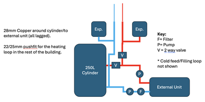

Hi, the graphs from Mel pump would be good. Can you draw your system, have you got a low loss header?  or are you directly piped into the house on one big circuit with one pump?

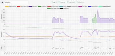

I've included a screenshot of the graph from melpump.com (much more informative than the MELCloud graphs!).
16 17 HP Graph
I had my DHW in Eco Mode and last night it was quite cold (down to 1C) so ignore the fact the system failed to heat my DHW properly in the window I gave it of 5-6.30am - so far as I'm aware it's just a blip and not something I'm particularly worried about (unless you say otherwise).

@davidnolan22 - Please see diagram attached.
*Edit - 1 issue in the initial version of the diagram.
Screenshot 2025 04 17 at 10.55.29
Updated version attached.

@cbrenewable Hopefully the diagram shows one of the valves in the wrong place, otherwise there is a valve in the wrong place.
Any idea why two pumps?

Struggling from the graph to understand why you would get a COP of only 2.4, its not doing vast amount of cycling (mind you its not delivering vast amounts of heat).

(@cbrenewable)
Posts: 16
@jamespa - yes, looks like I made a mistake on the diagram. I asked for the install to be quite compact in a corner of the garage so it's a little tricky to follow some of the pipework when it's partially obscured by the cylinder. Corrected version attached.
Worth clarifying that both valves are set to auto. I assume these are working correctly since my DHW temp doesn't show any anomalies when the system is heating.

Great. If you could post a picture of the area around the cylinder it would confirm that there is nothing untoward here.
