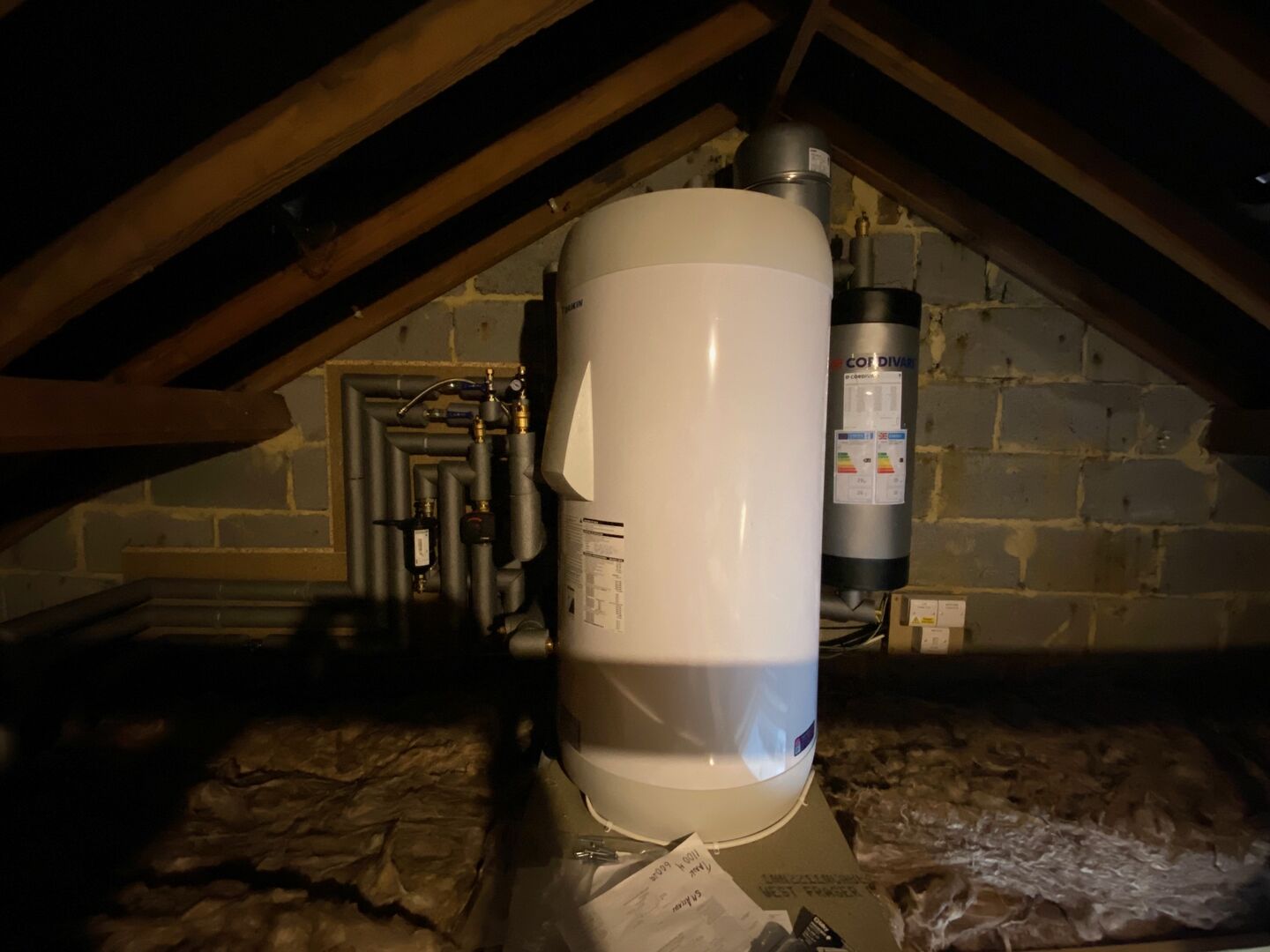

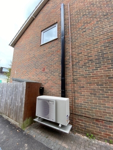

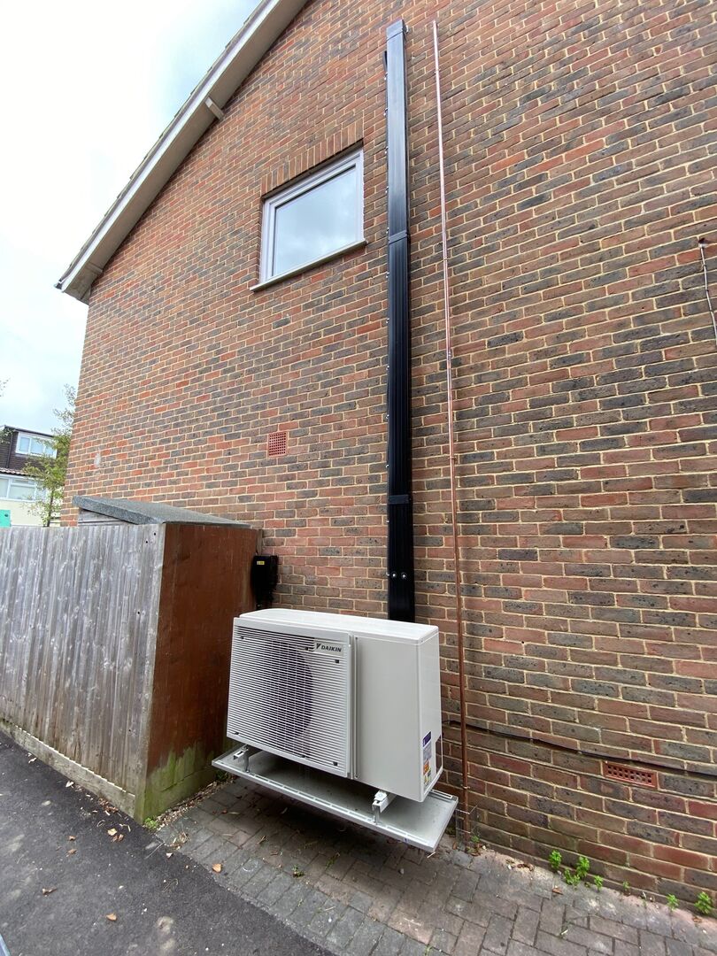

At the end we had the installation completed from Octopus two week ago and to be honest it was hassle free, aside from a moment where it appears we had to get rid of everything gas related to get the grant( I posted another thread on that) which got solved. The engineers were really helpful and as far I we know they have done a neat job.
I attach photo of the install. We have only used for DHW at the moment and find it amazingly quiet compare to what we expected.
Not sure how the buffer is working as it has been plumbed only top to bottom. I read numerous post on how bad buffer tank are for the heat pump, but find strange how in Italy are considered essential.

@rikiarn
Delighted to hear that the install went well.  It looks neat.
Posted by: @rikiarn
That buffer tank looks like its got only 2 connections, which is also what you appear to be saying.  In this case, provided both connections are either in the flow or in the return (not one in each), its a volumiser not a buffer.  These are just fine, unlike 3/4 port buffer tanks - which in principle can also be fine if correctly installed and controlled, which is rarely the case.
Fancoils are more popular in Italy than here and, they have very little volume of water in them compared to radiators.  This may be why extra system volume is considered essential in Italy.  Both a 2 port volumiser and a 3/4 port buffer tank add to system volume, the thing about a volumiser is that its almost installer-proof unlike a buffer which definitely is not.

@rikiarn It's a not a buffer it's a volumiser which is not the same thing. It helps keep the system on its toes during defrosts in the winter, for example. It has no impact on efficiency. So no worries. 🙂
