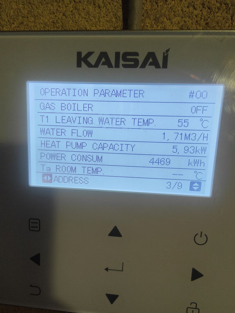

Here is photo from the controller. Temp is 55C but it did go to 56C for a bit too.
With an LW of 55 you will struggle to get to 52, but you should get to 48 I would have thought.  Does your heat pump allow you to increase the max lwt for dhw?

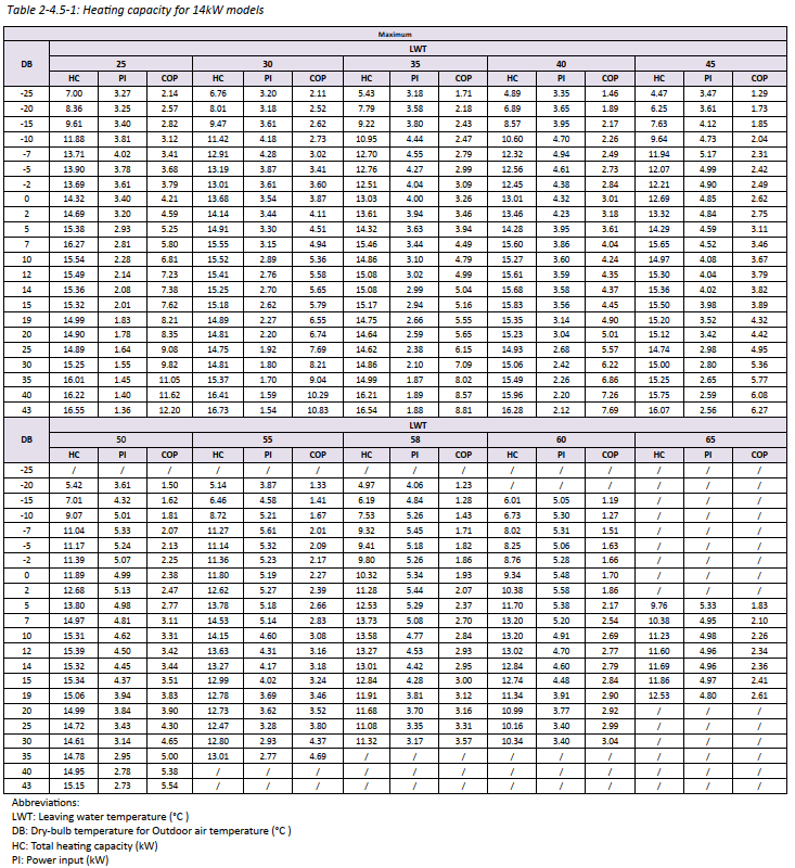

Here is the capacity table. Around 9kW heating capacity at -10C i think should be enough.

According to the table the capacity at -10/60 is only 6k.7W.  That should still be enough!
