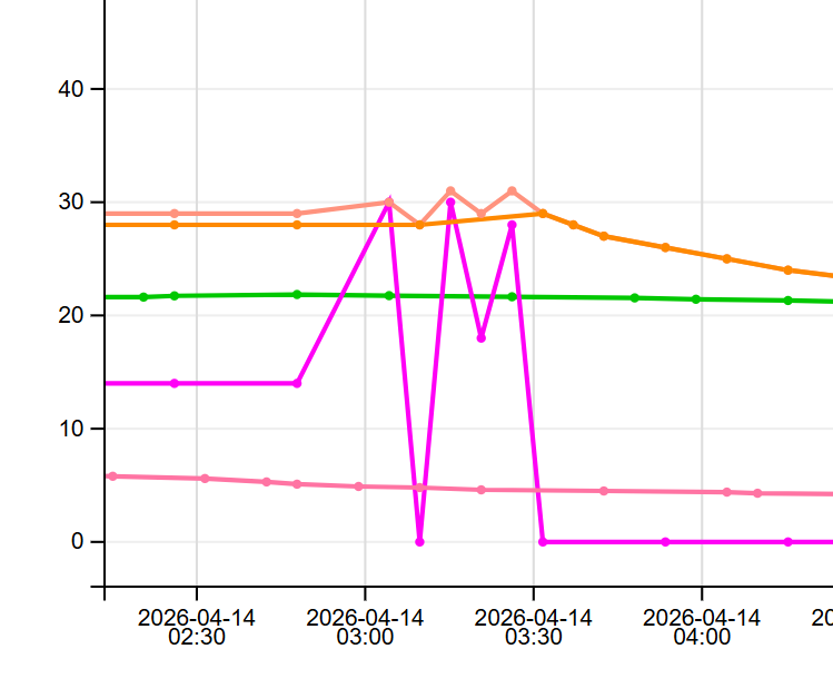

Final Update.
Yesterday, I was going through the motions of looking at how each menu impacts the Set Back flow temp. I considered the combination of WC, Set Back, Decreased Water Temp - a parameter in the Circuit 1 installer menu ( although termed Decreased Fixed Water Temperature in the controller menu). I then compared the settings I have now with past settings and accounted for Flow, IAT, and OAT temps including WC. I concluded that on at least 90% of nights during the shoulder months, and almost throughout the winter, the flow temp needed to be 19 degrees or lower (inlet and outlet) before the HP came on during Set Back. It was at this point I walked away from the computer and used logic. Apart from an odd event, this has not been an issue for two years on the same settings I have now, so something as changed and it isn’t the weather.
Then I got woke up in the night with the Heat Pump going on and off AGAIN!
At around 2:45am the inlet and outlet temperatures were 28 and 29 degrees respectively (see image). The IAT was 22 degrees, and the OAT was 5.3 degrees. The curve was quite low at 6 with a -1 shift.  For me, and other Aerona 3 owners I’ve spoken with this is not right. I’ve gone through months of graphs where during the night the IAT and OAT are similar and often much lower than last night (Inlet / Outlet 20 degrees, IAT 19 degree and OAT 3 degree) without the HP coming on.
This is the clearest example so far that something is not right. Ironically, since first posting this on the forum, this issue has gone from appearing once every four to six weeks to every night.
I found another Aerona 3 owner with a similar issue who found that a factory reset on the Smart Controller, and checking for loose or poor CAT 5/6 connections cured the problem. I’ve carried this out this afternoon.
If it happens again tonight, I’ll schedule the Pump off during the night and put up with the circulation pump pushing through the ABV during frost protection (for at least the rest of the cold spell). Something will give at some point. If not, then it’s time to ditch the Grant and replace it with another manufacturers HP. Hopefully, this post might aid other Aerona 3 owners if they experience similar issues, and like me, think they’re going insane!
