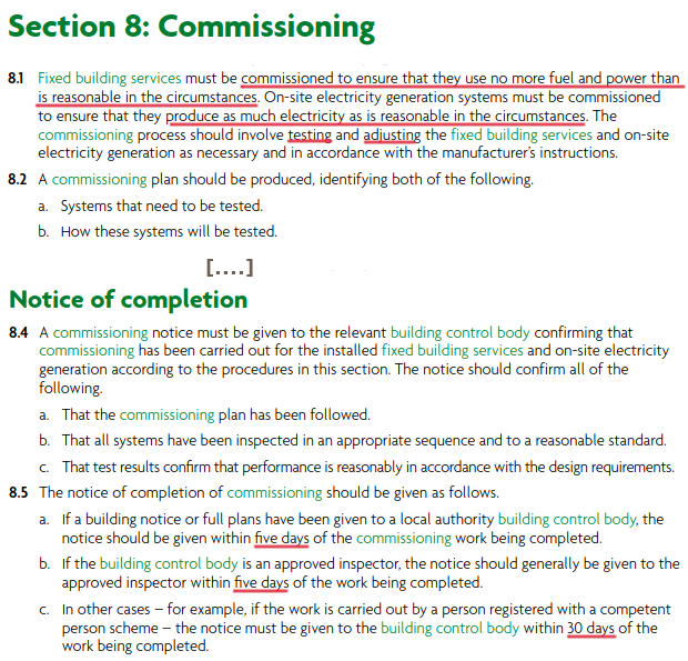

B: A schematic which shows what the company has actually installed on-site.
It will need to identify each valve and controller, together with the pipes and wires that connect between them.
There will also be a Commissioning document, describing how the system was tested and the results.
This is all required to satisfy Part-L of the Building Regs.
That schematic should be accompanied by the specific instructions/explanations of the installation so that it can be operated/maintained by the customer.
A pile of manuals for each installed device is insufficient.
So in @david999's case, the 'Manager' should be able to produce both sets of documents/diagrams (pre- & post-installation).
If not, then the system hasn't been 'Commissioned' and no Notice should yet have been given to the Building Control Dept of your LPA.
Part L 8a
