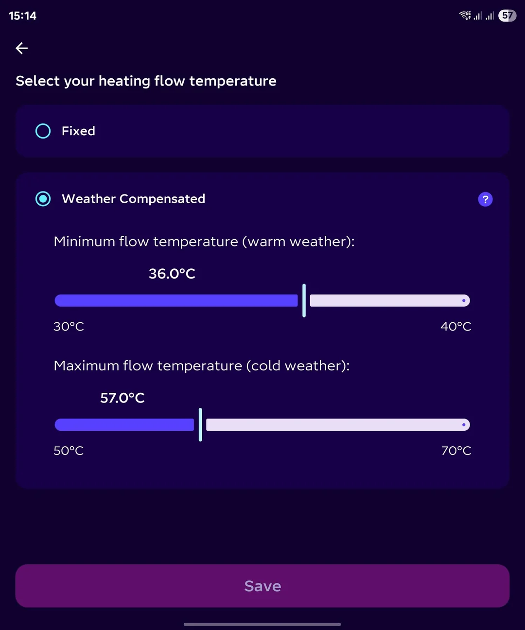

I have been tracking every move and have now managed, I think, to balance the rads (and yes, upstairs was getting all the warmth!) and my WC curve is currently set at 34/55 with a target temp of 20c, which is being met easily but with some with some cycling. So, my latest settings are set at 19:00 on the 18th, so my aim is to tweak those later this evening to 34/54 and to see what happens tomorrow. Wish me luck!

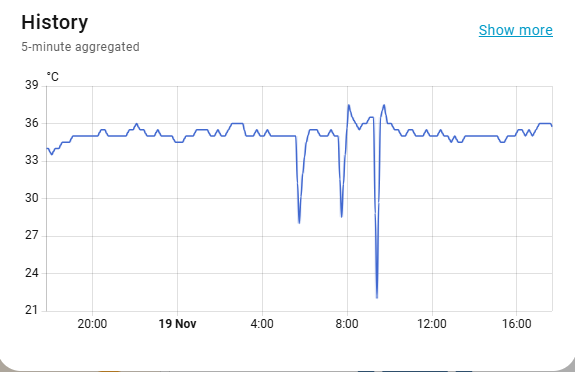

Here is what my Vaillant (running on pure WC) has been doing today - no cycling just 3 defrosts - the plot is of flow temperature

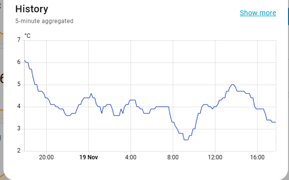

Here is the OAT, which, now I look at it, has been a rather good day to adjust heat pumps!

@jamespa Yes, I now get that the 50c top end of the wc range is too high, though I I can still try dropping the setting back for 5 nights (55 to 50) and see where that lands me. If it is still too high, I’ll follow your advice and tweak the target temp up…is that right?
Now, it has got me thinking. Looking at my existing curve, at todays AOT of around 2c, my FR should be around 42/43c, a good 9c above yours. Thinking back to a comment by TJ (the Octopus bod who pops up occasionally) the target ought be about ‘FR+15c’, which suggests that at AOT of 2c and a target indoor temp of 20c, then my FR ought to be aound 35c.
Does this sound about right? I have no possible way of achieving that using WC however, although it is possible if I set a static setpoint. But do I really want to do that? No.
