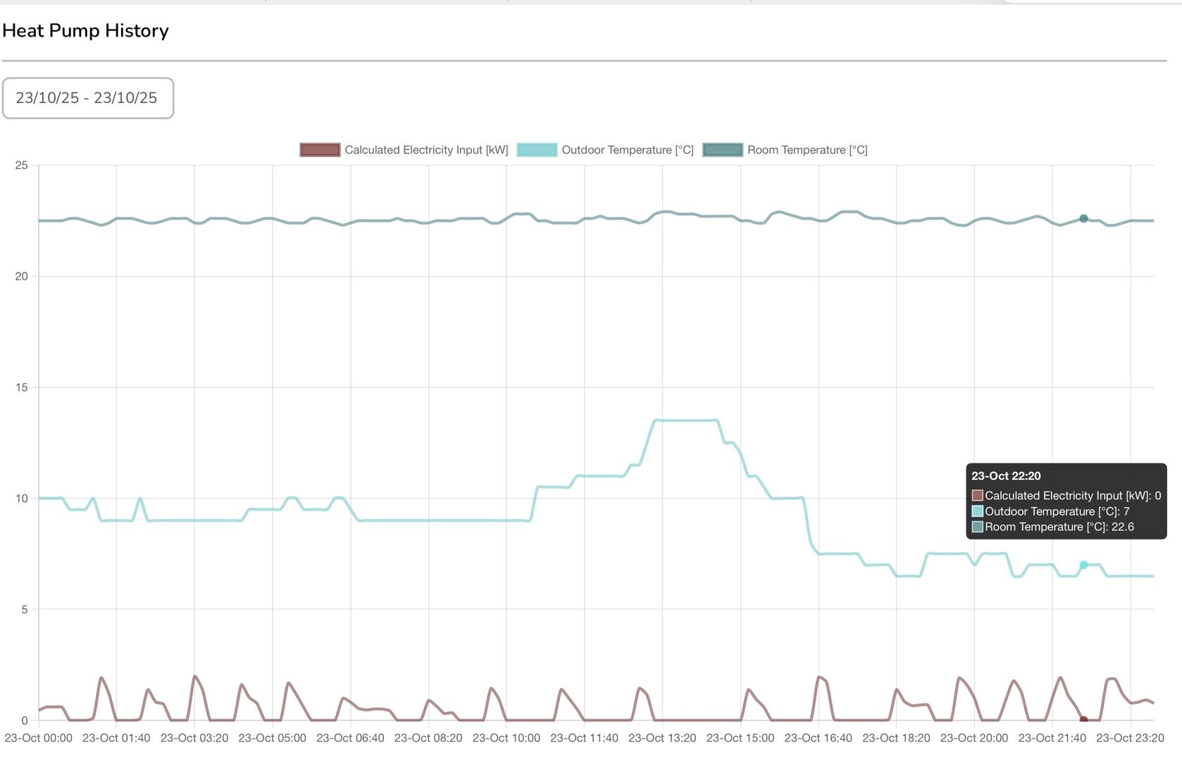

@andrewj In case the comparison is worth anything, here is a chart showing the Homely controlled 8 kW Daikin EDLA08 monobloc for the day of 23rd. October. The values are for IAT (set to 22.5 degrees C 24/7) OAT and power used. More details of my home and insulation etc. in my profile if you wish to read it. The COP was reported as being 4.2 over this period. Regards, Toodles.

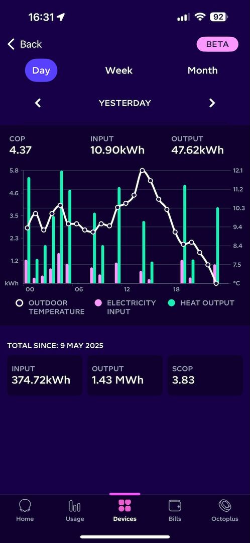

Interesting, thanks.  It looks like yours is operating on/off as well (currently) - I don't see the total power input or a kWh scale.  The Cosy yesterday, showing input/output and OAT:
IMG 2423
It reported a COP of 4.37 so very similar.

@andrewj The power consumption varies between the peaks at switch-on of ~1.7 kW and ‘tickover’ at about ~300 - 400 Watts. I note that today with lower temperatures, the pump is running most of the time - ticking over between ~400 - 800 Watts. Regards, Toodles.

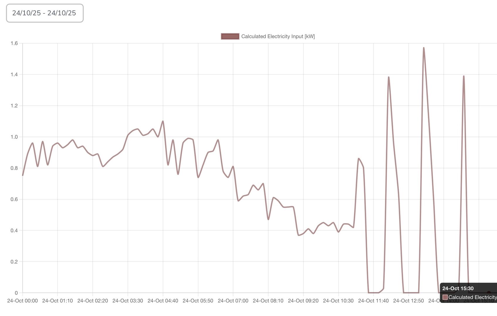

@andrewj In this chart, I have selected just the power demand and this in turn also indicates
IMG 1376
when the pump turns on and off. Regards, Toodles.

@toodles Thanks - it would seem that apart from the cycling mine does (it can't ever stay continuous) then power consumption is similar.
