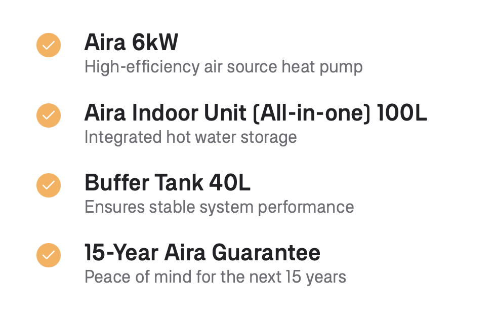

The recent ZeroDisrupt discussions reminded me to take another look at Aira. I went through their “Get a Quote” process again, and it raised a familiar red flag: the automatic inclusion of a buffer tank on every install.
For those of you here with an Aira system, did you ever question the need for the buffer? And if so, did Aira provide any justification for including it, especially given the extra cost it adds to the overall system?

@editor hi Mars, after being let down by Octopus, I was to a little too hasty in my decision making. Aira was the next best cheapest at the time. But they were not the only one who quoted with a buffer. I wasn't aware at the time, how much the experts advise against a buffer. I did question why they only fit with a buffer. They explained that the system was specifically designed from the ground up to use the buffer. I have evidence of the system adapting the flow temperature depending on the buffer tank temperature. Not sure if others do this or if this is unique.I Have now had the system over a year and it has worked well. We saved about £400 over gas.if you believe Aira's own heat delivered and energy consumption data we had a SCOP of 4.64 over 12 months.

@editor when I was looking for a HP I went to the Fully Electric Show North and Aira were there. At this stage only a few test HP’s had been installed. However this gave me the opportunity to speak to one of their designers and I asked about the buffer tank. He said that the system has been designed to include a buffer tank which increases its SCOP. I ask how and he tried to explain that it was way the water entered and left the tank and was a variable temperature. It also had volume so when a defrost is needed this means that this water can be used rather than water from the system which would then require that water to be rapidly reheated to keep the house warm. With their buffer tank the HP could continue on a slow continuous output therefore increasing the SCOP. We managed to achieve a SCOP of just over 5 which I’m happy with. I don’t care if there is or isn’t a buffer as long as it works, obtains a good SCOP and saves me money. Having a battery will also help.

This is interesting indeed.  It is undoubtedly the case that buffer tanks can work, the problem is that they are generally thrown in by installers unnecessarily, poorly set up and with poor or no controls and subtracting rather than adding value.
It is indeed possible that Aira, having more control, have actually 'got it right'.  If so it would be good to get some more detail, not because it will give us reason to change what we generally think about buffers, but because it might carve out an exception for Adia because of the way their install process/controls work.
