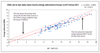

I'm still not sure! Consider this chart with an added line which represent to total heat loss:
My reasoning: the added upper dotted line Y intercept is the 'everything in balance' point: OAT = IAT so IAT - OAT = 0, no energy is needed to keep something in balance that is already in balance. But the real point of interest is where the solid line crosses the X axis: this is the point at which the primary heat source no longer has to supply any heat, because the other heat sources provide enough. How much extra heat that other heat provides is shown by the vertical distance between the two lines, which as it happens is conveniently measured by the Y axis intercept, even if a that point we have the non-real imaginary concept of a heat source that puts out negative energy. So to get the total heat loss (represented by the added upper dotted line) you have to add the other heat sources energy to the heat pump energy, to get the total needed to keep the house in balance.
Or am I just being very thick?

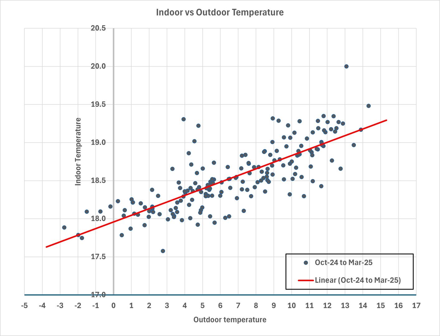

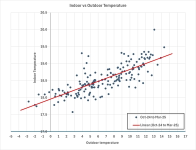

Below is a graph of daily average indoor temperature plotted against daily average outdoor temperature for my house for the period Oct-24 to Mar-25. For these six months, the heating was off between 10pm and 6am every day.
Indoor vs Outdoor temperature
Aside from some outliers, there is a clear trend of lower average outdoor temperatures resulting in lower average indoor temperatures.

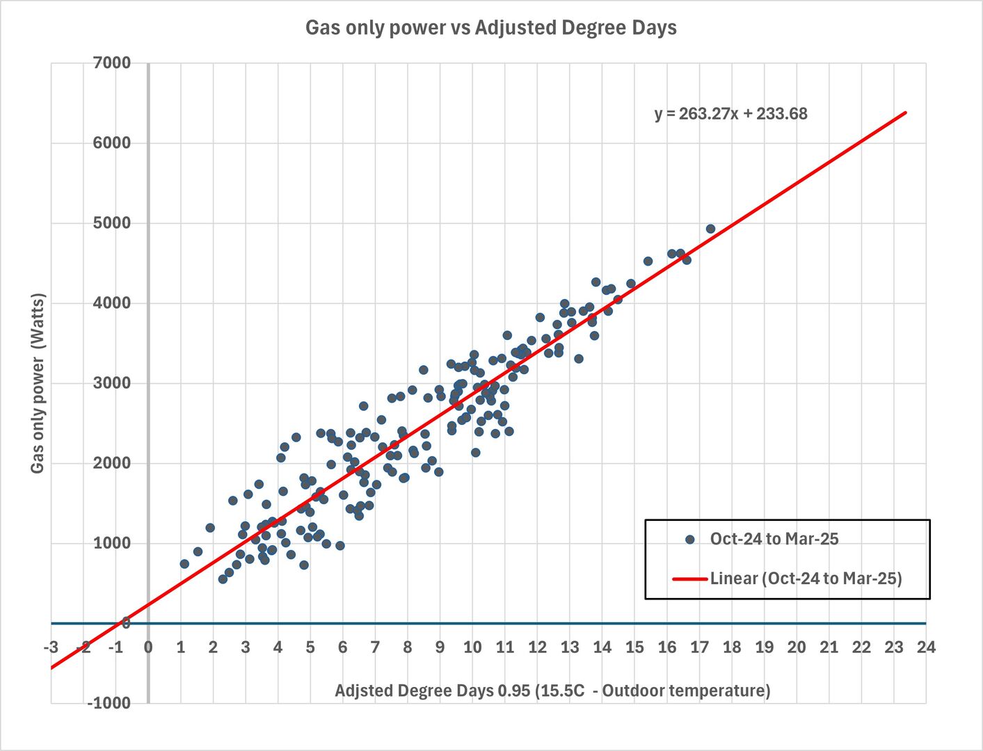

So, what happens if we plot gas power output against 0.95 DD instead of just DD.
Gas Only Power vs Adjusted Degree Days Oct 24 to Mar 25
The plot of power (gas only) vs. adjusted degree days gives HTC = 263.3W/C and power from other sources of 556W (negative of x = -3C line intercept, given my average indoor temperature of 18.5C, and degree days definition of 15.5C). Hence the heat loss at a 24-degree temperature difference is 6320W less 180W for hot water gives 6140W, which is less than 150W below the results from previous calculations based on more accurate temperature difference data. The power from other sources of 556W is probably still underestimated here. The power required for space heating is 5580W and 180W for hot water, which is within 100W of the more accurate estimates obtained using temperature differences.
In conclusion, adjusting the degree days by a factor of 0,95 provides a way of accounting for the fact that lower outdoor temperatures tend to feed through into lower indoor temperatures, and are certain to do so if the heating is turned off overnight.
