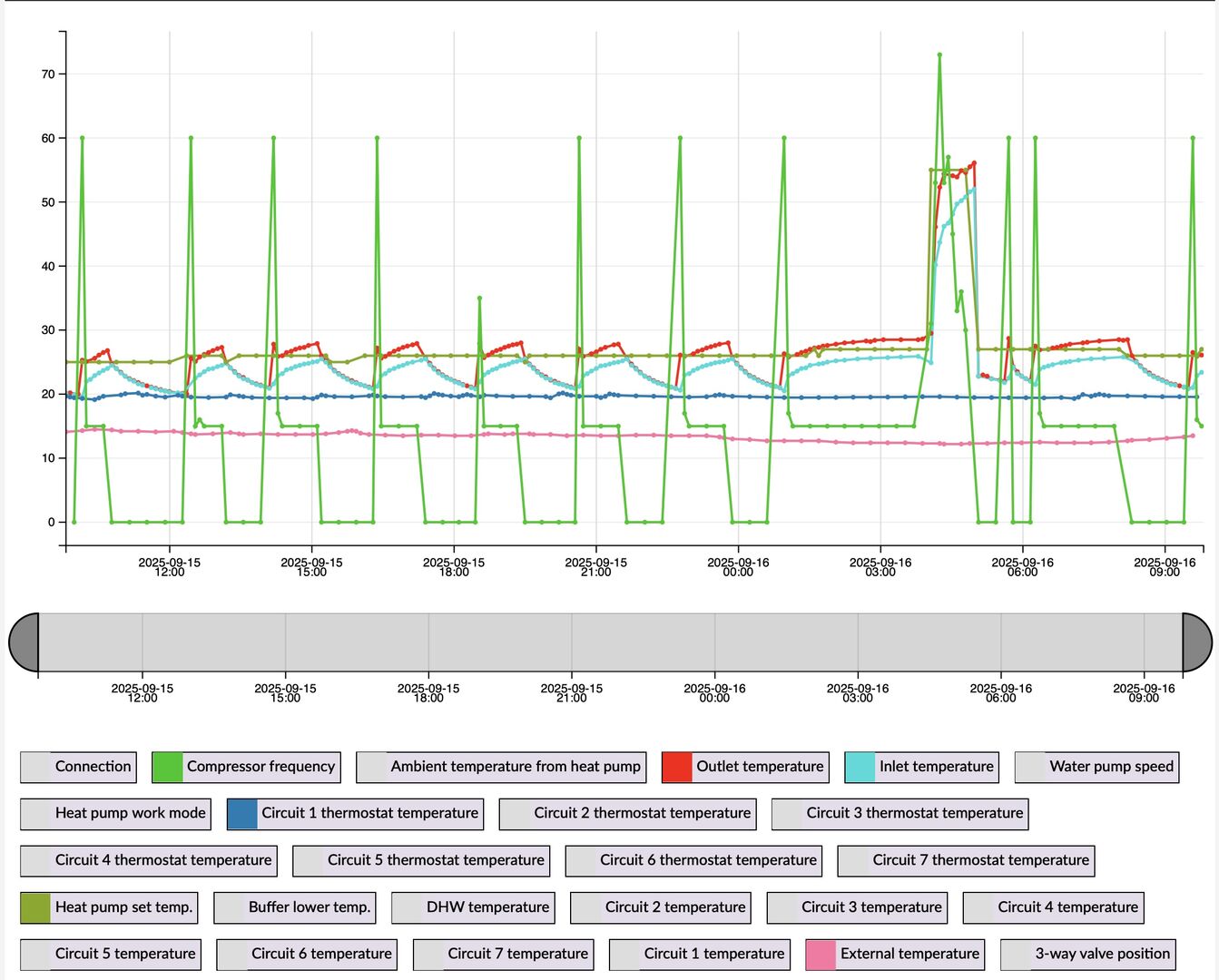

It is interesting to see what our new Grant Aerona 290 15.5 kW heat pump is up to.
Here is a snapshot from the Econet web site for the last 24 hours:
Image 16 09 2025 at 10.29
The external temperature has varied between 12.4-14.5C (pink).  The weather compensated flow temperature (dark green) is set to 25-27C.  When the heat pump compressor comes on, it mostly runs at its minimum frequency of 15Hz.  As you can see from the sawtooth shape, the flow temperature (red) goes up to about 28C, and then the heat pump turns it off - presumably because it is above 25-27C.
The Circuit 1 temperature of the only thermostat in the hall has varied between 19.1 and 20.2.  The heat pump has been on only about half the time, so the weather compensation curve is probably in about the right place.  Unfortunately, the heat pump won't go quite that low.  I am nudging the WC up slightly to try to get the average closer to 20C.
Maybe as the outside air temperature reduces, the heat pump will be able to output at 25-27C, but by then I will probably want it to be higher!
Glynn Hudson seems to be getting similar behaviour on his Aerona 290 9kW system, but he seems to prefer a higher room temperature of 21-22C.  His flow temperature is correspondingly higher and the compressor is running continuously.  There are 3-4 one hour slots when the compressor stops, but I don't know if that is based on a schedule, or the heat pump controller's decision.
