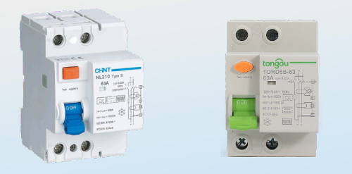

What is foxing me with doing this is getting the type B rcd for CU I have, so I cant move the ASHP from its Cinch CU which has the type B in it :-/
Would that be a Chint RCD perhaps?
Have a look at this topic on high current trips, where I mention a number of potential manufacturers and suppliers for the trip being sought by BatPred.

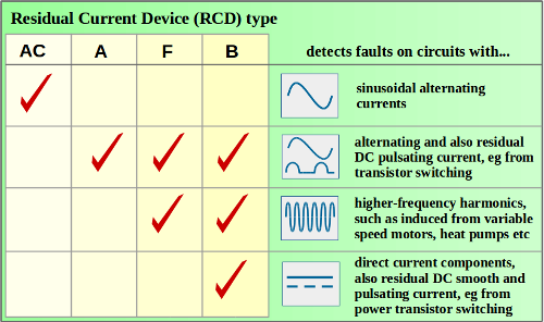

For the benefit of others wanting to follow this discussion,
this chart shows the features found in the four types of earth leakage trip:
RCD type
The majority of EV chargers are installed using a Type-A trip.
But the OVO Trial of V2G chargers five years ago showed that there was a significant DC component in the fault leakage current.
So they installed Type-B trips from then on.
Type-B RCD trips used to be very rare, and cost more than £200 each.
For a V2G charger, it would also need to be bi-directional of course.
