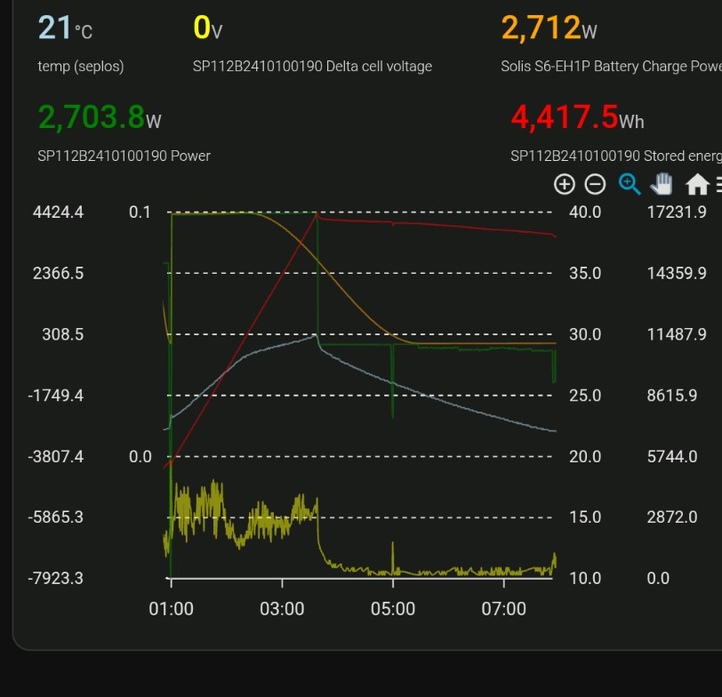

I know there are a number of charging periods but had not thought of using them that way. My assumption was that the inverter had automatic charge phases, bulk, absorb, float like a battery charger which information it must get from the BMS or its own current measurement? If an inverter just pumps in say 100A and stops dead on being told battery 100% that is mad.
Mine has a Seplos BMS, but I do not see the charging slowing. When it reaches 100 soc, it stops. Perhaps the slowing only works with some specific BMS setting.
With Seplos, both Jinlong/Solis and Pylontech protocols seem to work with the Solis. I left it with Pylontech.
@bash has it slowing down, is this using Pylontech?

Yes, here's a.mix of Bluetooth and modbus based ones.
@transparent @bash
It seems the Solis is providing a moving average of power, making it seem that it gradually reduces the power as the battery reaches soc of 100 (orange).
But the same power reading from the seplos bms via Bluetooth shows a very sudden drop (green). In this case, the seplos seems to be right, as I cannot see how a smooth curve could be synthetically transformed into a sudden drop, but the opposite is simple. The temperature curve also supports the same interpretation.

@batpred
I don't recognise that screenshot you have posted.
I spent many nights working out why the unit's weren't balancing as well as I'd hoped using the Seplos desktop app.
Once the batteries reached around 97-98% capacity the BMS would ask the Solis inverter to ramp down the charge rate, dropping to around 10A, possibly 5A, from the requested 100A charge rate I set
This slowing of the charge meant the JK balancer had time to top balance the cells before one (or more) ran away and caused an over voltage alarm/cut-off.
I haven't checked for a while as I don't fancy spending another night waiting until 3 or 4 in the morning to observe!
If I get up early one day and it's still charging I'll take a screenshot for you.
