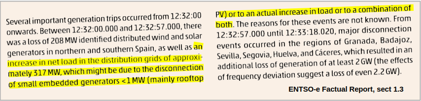

IberianTech 1 3
The quotation is taken from the Factual Report on the Iberian Outage of 28th April 2025.
Small-scale embedded generation suffered a Cascade Effect, requiring the Spanish Grid to make up a sudden shortfall of power.
Historically the grid would've remained in full operation because of the inertia provided by generators using rotating turbines.
But when these are progressively being replaced by electricity from renewable sources, it leaves the grid more susceptible to an outage.
Once we start enjoying the financial benefits of exporting to the grid, we assume the social responsibility to continue doing so.
That's what should occur with a correct implementation of G98.
But we're now beginning to see chinks in that armour.
