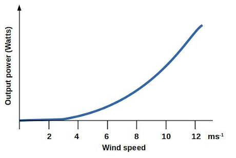

1: You won't achieve any useful output from a turbine at a wind-speed below 3m/s. It's just idling.

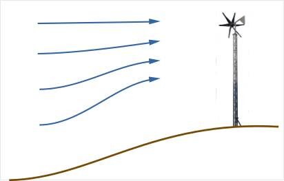

2: If you want to erect a turbine tower less than 15m high, then you need to place it on the upslope of the prevailing wind direction. That just happens to suit where I live! As the ground rises, the air get compressed and the effective wind speed is multiplied.

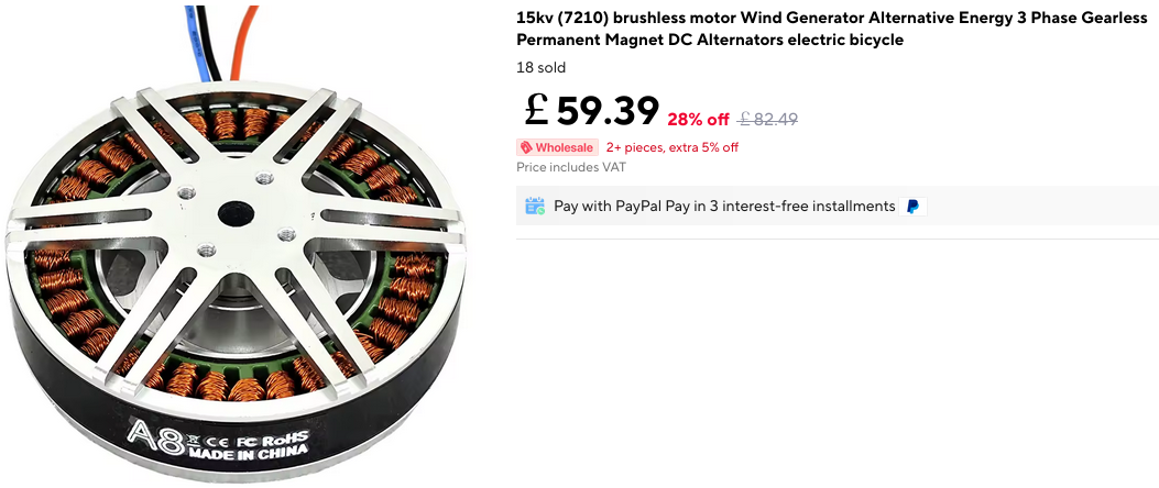

Of course, there are also rogue traders who haven't a clue what they're offering for sale.
Here's a 15kilovolt 3-phase DC motor, for example!

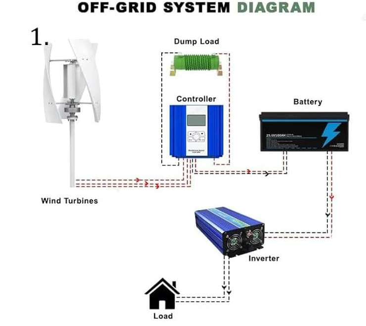

There seem to be plenty of systems available, including that Dump load component, essential to deal with over production.
