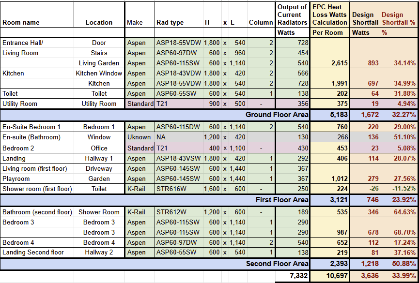

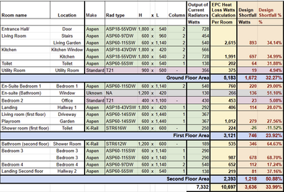

Posted by: @drei
This is my current workout with keeping as many existing designer radiators as possible, and only slapping in a 2m K3 in the living room:
The spreadsheet shows positive figures as the shortfall, in red, and the negative figures are green and good as these are higher than the existing heat loss. Hope it makes sense.
This looks OK. Overall you have roughly the right amount of heat going into each floor.
What is the design temps for the bedrooms? Is it already low at 18C, or have they designed to 21C so less of an issue with the bedrooms being a bit on the low side? Also, heat rises, so I wouldn't be too concerned if bedrooms on higher floors are a little under specced (unless you like toasty bedrooms)
The main living space on the ground floor maybe more of a concern (to me). I would focus on that, getting as much heat into those rooms as possible, as if the ground floor main living space is cold, it's all down hill from there and risk ending up with a living space that is hard to heat and bedrooms that are roasting by the time you go to bed (the opposite of what I prefer) as the heat constantly escapes to the higher floors.

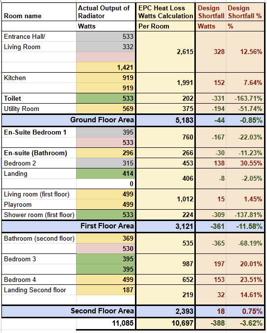

My current actuals are as follows:

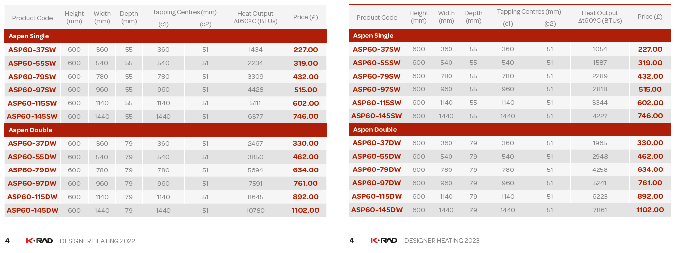

There is no wonder that my SCOP is so low. Also, most of my shortfall is due to the installers using outdated radiator data, see below:
2022 vs 2023 Comparison
