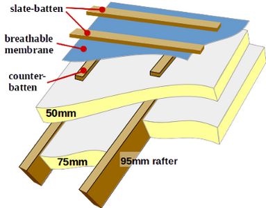

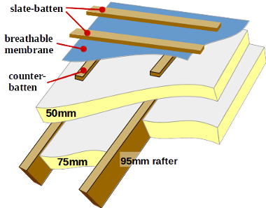

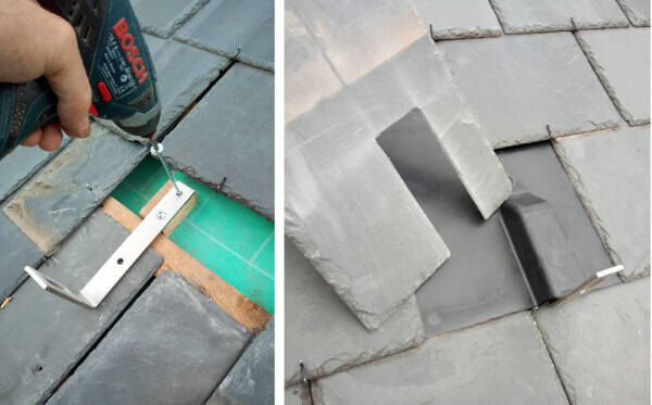

My own solar panel fixing rails wouldn't pass the MCS regulations, but the accredited installer who fitted the first 5 panels decided to use common sense.
The roof fixings were supplied with the relevant 8x85mm hex-head bolts which must pass through the roofing felt and into the rafter below.
However, I have a warm-roof construction. There's insulation between the rafters, then another 50mm outside. The external insulation is held in place with 50x25mm vertical counter-battens, then the breathable membrane, and the slate-battens nailed horizontally on top.
WarmRoofDiag
That meant using a screw 150mm long, which is 'not MCS approved'.
And I also allowed for two per fixing position.
Fix1b 5b
I don't suppose there's any photos of your fixing rails being installed is there?
That would be useful to give to a prospective surveyor.
