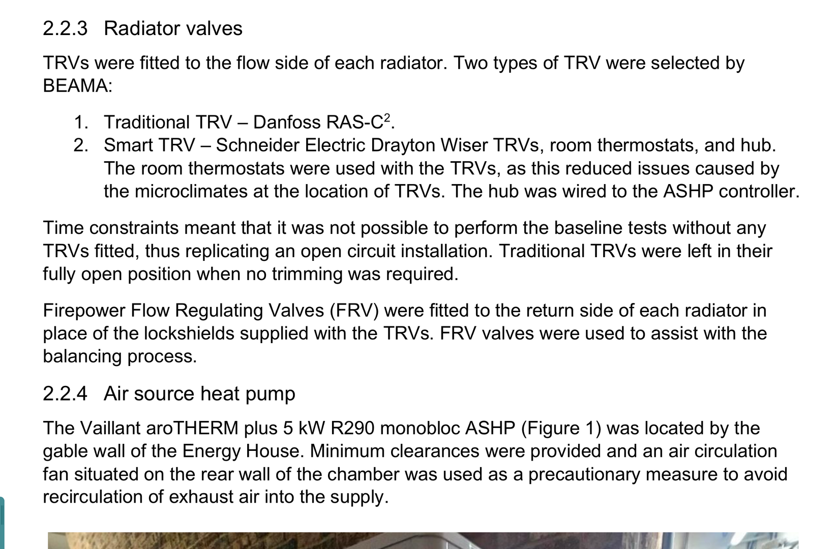

@jamespa I’ve read as much as I’m willing to on this report.
The baseline against which the 6-8% saving in electricity consumption was stated is untrimmed radiators. The trimmed and both types of TRV were effectively the same. So I stopped reading there, page 26.
IMG 1025
An interesting comparison with the Samsung ashp though (a previous  test), which would fault on no flow whereas the Vaillant gave no heat output below its minimum flow rate (page 10) but worked fine once valves opened again. This Samsung needed the ‘fix’ of a 4 port buffer and this design feature has been used across all ASHPs for a while since.

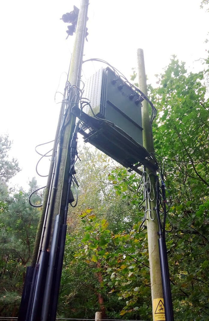

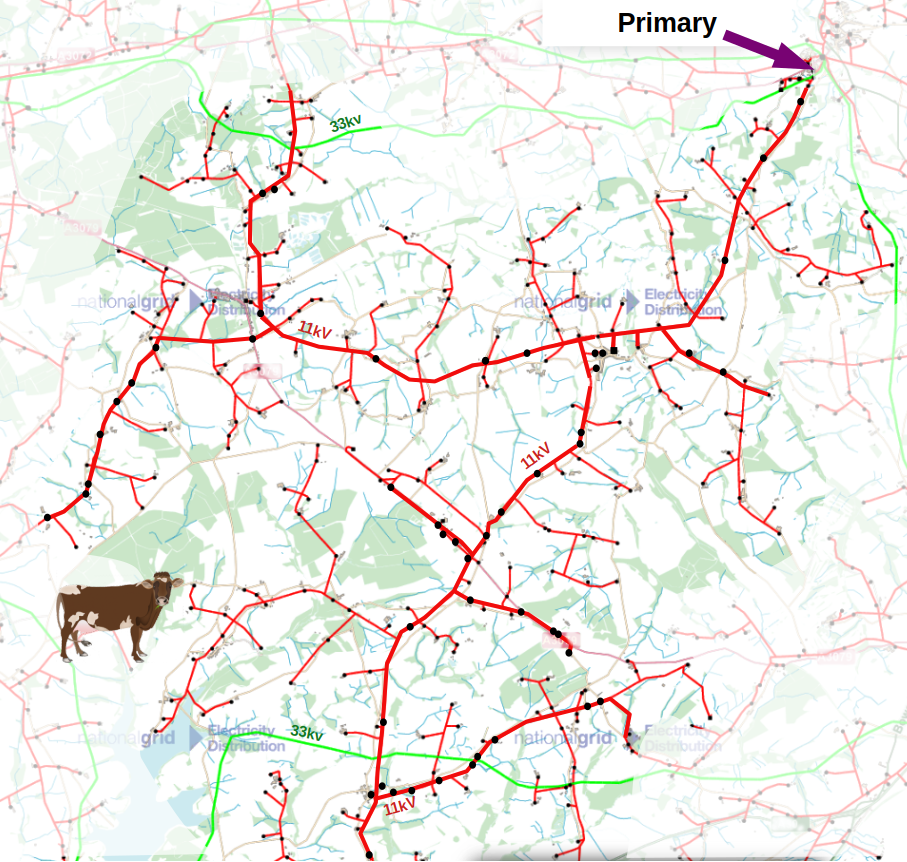

How much thought has gone into the technical consequences of this move do you think?
Let's stick with GB and ignore the fuel-mix in Northern Ireland for a moment.
The majority of homes heated by oil are in rural areas, beyond the reach of the gas supply network.
Those same areas are more likely to be supplied with electricity via long 11kV overhead wires, which suffer from voltage drop.
11kv genericB
The 11kV level of the grid must be maintained within 6% either side, which translates to 10,340v – 11,660v.
The Electrical Networks Association (ENA) is currently moving towards a reduction in LV supplies from 240v to 230v. That doesn't require any change of legislation because the Electricity Regulations, section 27 already uses 230v as the specification.
The reduced voltage will leave greater headroom for export from embedded generation, such as domestic solar panels. It becomes less likely that domestic inverters would drive the voltage above 253v, which is the statutory maximum. Hence more export could be accommodated.
However, the DNOs aren't simply going to visit all 550,000 local substations and change the transformer taps. That would be far too expensive and take years. Instead they will adjust the taps on the Primary transformers which deliver 11kV on their secondary windings.
Reducing LV from 240v to 230v is a 4% change. The 11kV level therefore moves to the envelope 99,270v – 11,194v.
So what will happen at the end of a long rural 11kV feed?
During times of peak demand (eg milking time) those rural supplies are already often dipping below 216.4v, which is the statutory minimum.
Yes most grid-tied inverters will continue to operate. G98 doesn't require them to have decoupled from the grid until the line-voltage finally dips to 184v. But somewhere between 184v – 216.4v more of that embedded generation will be lost. Consequently the line voltage falls yet further.
These voltage reductions may allow more export from renewable generation in rural areas, but at greater risk of there being a Cascade Event, when a wave of inverters cease operating across the rural countryside.
That's what happened in Badajoz on 28th April 2025, and was the final trigger which led to the Iberian Grid collapse. The loss of just 317MW of domestic embedded generation was sufficient to instigate a national grid outage. 11 people died.
Simply offering £9k grants for homeowners to install electric heat-pumps is an easy decision to make in Whitehall.
But it's a decision which isn't founded on grid data. The only local substations which have ever been monitored are ground-mounted. But 66% of 11kV/LV transformers are pole-mounted, and those are the ones in rural areas where homes are presently heated by oil.
PoleMountTransformer

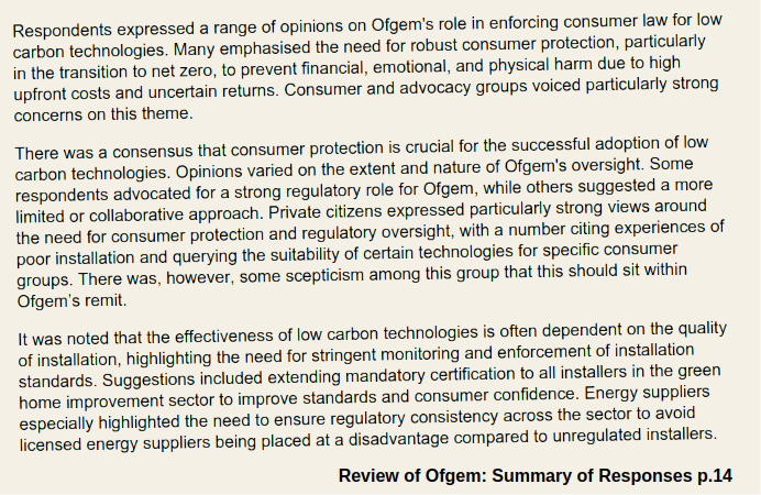

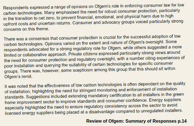

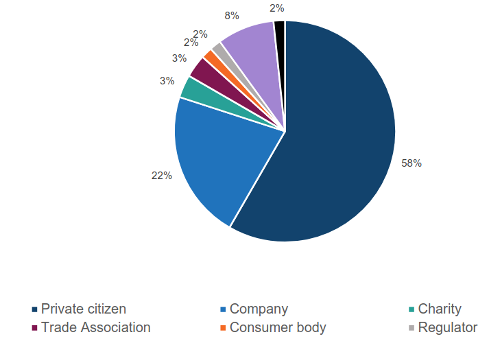

Government has just published its Final Report on a Review of Ofgem from a public consultation launched in Dec'24.
The original Call for Evidence is here at the bottom of the page, and a link to a Summary of Responses higher up.
There were more than 20,000 submissions, which is extremely high for a public consultation, with more than half being from ordinary members of the public:
Comments included Ofgem's lack of transparency, and confusion between its role as the Regulator and that of NESO, which has the remit to achieve Net Zero.
Usefully, there are comments which will resonate strongly with Members here on the RHH Forum
ReviewResponses
The high level of public response should be a wake-up call for those with an electoral mandate.
Consider drawing your MP's attention to these findings, and ask them to ensure action is taken to address public concerns.
This post was modified 7 months ago 2 times by Transparent
