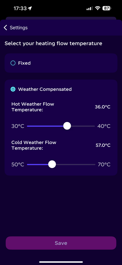

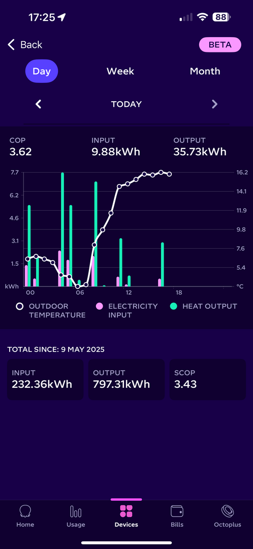

and @majordennisbloodnok I just went to make a cup of coffee and ponder whilst that was happening. I thought: "perhaps it is already running at the lowest flow temperature it can achieve and that temperature is high enough to heat above the requested temperature, in which case the only way it can bring it down again is by turning off."
I think that concurs with what you are both saying and that I will see behaviour in line with my expectations as the weather gets colder. I suppose that also means some rooms are likely to be cooler than others simply because of this thermostat-like behaviour. This is my first heating season by the way, it was actually installed at the beginning of May and has never had the heating function turned on. As long as I can explain this to my wife I should remain on steady ground!!
The attached image shows its behaviour today. The other image shows the setup for WC.
Posted by: @andrewj...
Yes, I think it does concur.
Regarding some rooms being cooler than others, I suspect that may have more to do with radiators not being as well balanced as they could be. There's another article - this time by @toodles - covering this and it's here. Balancing is often not done well by installers simply because it takes more time than they have available, but it's a straightforward process for a homeowner to do and gives good results once done.
