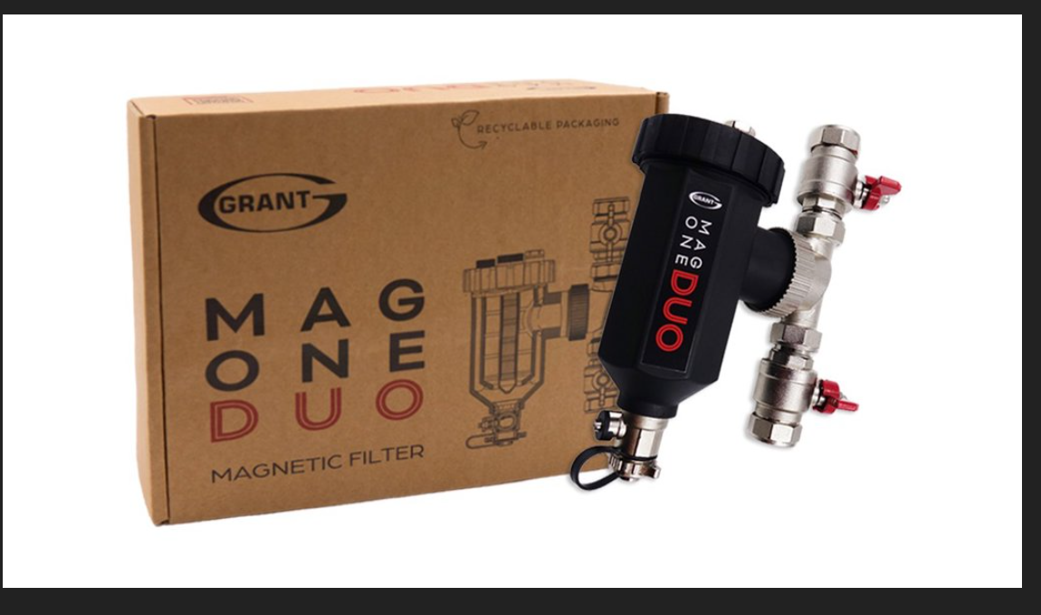

Before we move onto controls the one thing that worries me significantly about the list of problems is the lack of system filtration.  This is serious and will eventually lead to a blocked heat exchanger which is an expensive fault.  The Grant installation pack comes with a magnetic filter looking like this or similar.  Can you have a look round the system and check that there really isn't one or something like it.  While you are looking round perhaps you could take and post some pictures, particularly in the area of any tanks.
I would also, if you haven't already, contact DCC and complain, listing the specific faults that were identified by the Grant engineer, explaining that MCS and Trustmark are unable to help and asking them what you should do next. Also ask who their contract was with, this is important because, if it was with EnergySmart, who are still trading, there should be recourse to them notwithstanding that the actual installer has ceased trading.  As DCC paid, they are the customer with such legal rights as they may have, unless you also signed a contract (did you?).  Once we know what they say there may be further steps but it has to start here as they paid the cash!
Depending on DCCs response it may, if you have the money, be worth paying for a filter to be installed as it will save a lot downstream.  Lets see what they say.
