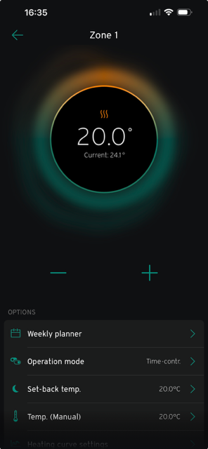

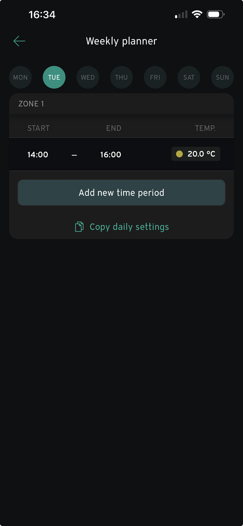

Powering up my new Vaillant which was installed earlier this year, so just testing ahead of the season. So I have set INACTIVE as I wanted to run full weather compensation (so NO influence of any temperature controllers). And as a test today I set a weekly planner for the HP to run for 2hours between 2pm and 4pm. It came on at 2pm but didn't turn off at 4pm.
So when running pure weather comp, is the weekly planner NOT active? Screen prints of my set up attached.

I don't know the answer for certain as mine is on 24*7 but is it possible that, when in timed mode, 'off' is actually 'setback'.
Some conventional electromechanical thermostat controllers work this way and it's more than possible that Vaillant does. Worth checking the manual and/or programming explicitly a rather low target temp in the off periods to see what that does.
Also don't forget that the way the Vaillant target temp works (when room temp mode is 'inactive') is to modify the WC curve not like a thermostat, so reducing the target temp turns it down not off.

JamesPa Thank you for the reply. Its all about configuration. So now with my schedule set for overnight and have set a set-back, all working fine on the tests I ran today.
I didn't know that the set-back effectively lowers the heat curve that you have set.

Yes, its described in the sensocomfort manual. Its also very sensible. Many heat pumps can only do setback by invoking on/off working, bouncing off a thermostat/temperature sensor. Vaillant and some others have gone about it a different way which ensures that you can program a setback (or set forward) whilst ensuring the heat pump continues to operate efficiently. Furthermore it preserves a familiar interface to setting room temperature (ie a simple dial) whilst at the same time preserving operation by WC. Brilliant IMHO.
If you want it to bounce of a temperature sensor you can also do that, just enable extended mode!
