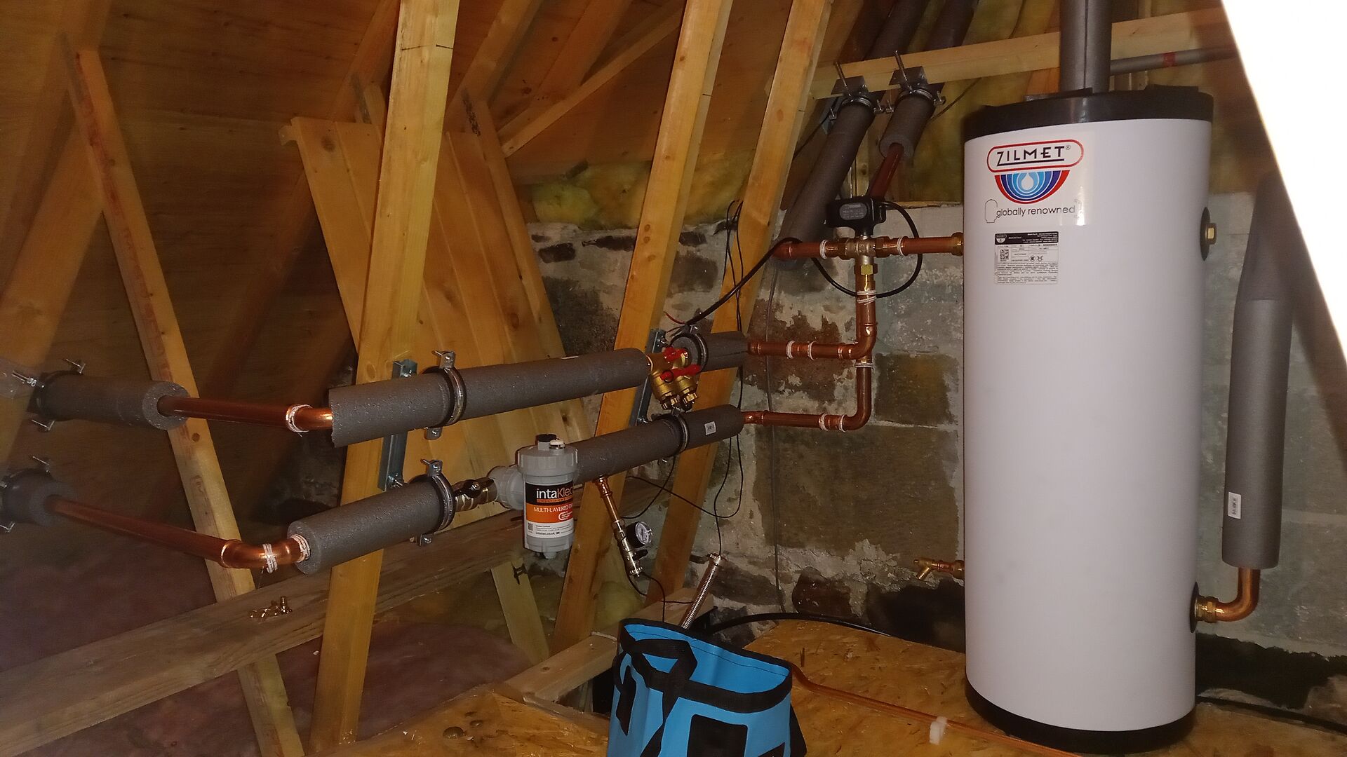

Getting closer to a finished system.
The pipes still need insulation but it's flushed and bled, now holding 0.4bar pressure after two leaky unions.
I've still got a completely new circuit to three radiatorors to connect on, but I thought it would be better to flush the old pipework through first; it also makes leak checking easier.
Time to wire up the control panel

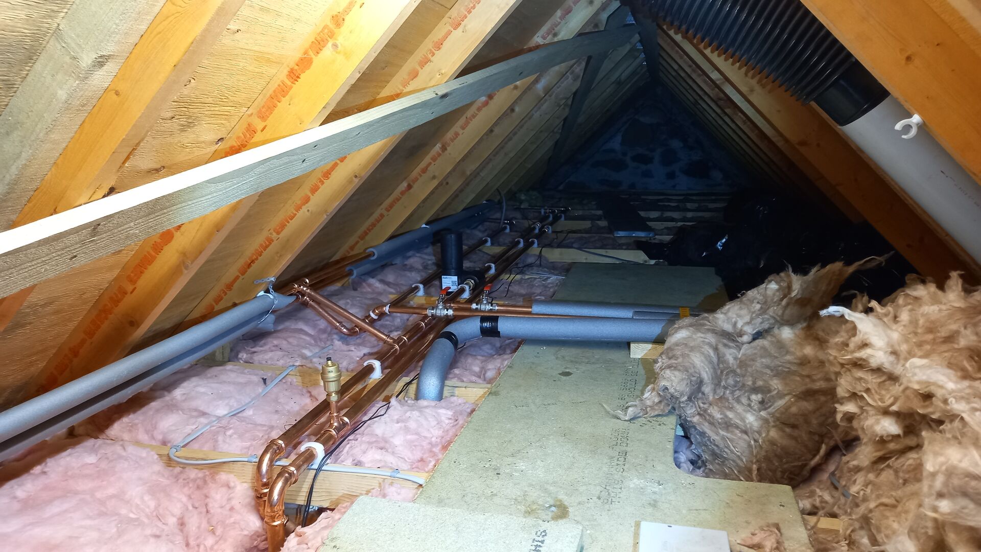

I've used pressfit fittings almost everywhere because the elbows have a nice swept bend compared with the much cheaper end feed or Yorkshire solder fittings. But I've tried to bend the 15mm and 22mm pipe wherever possible, rather than using fittings. Ends of the pipes have been thoroughly deburred to prevent undue restrictions.
If I was doing this again, I'd certainly be looking into a coil of 32mm MLCP instead of lengths of 28mm copper as the reduction in fittings would easily cover the cost of some new jaws. I'm sure it would have been easier/quicker and cheaper overall.

All the 45° elbows required for getting the primaries into a lower loft space, then up into the main loft to connect with the old primaries and HW cylinder was a mental workout and rather awkward
I could have avoided that by going up the outside of the house and drilling through the gable end into the main loft. But the wall is around 18" thick solid stone and there's some quartz and granite blocks lurking under the render 😬

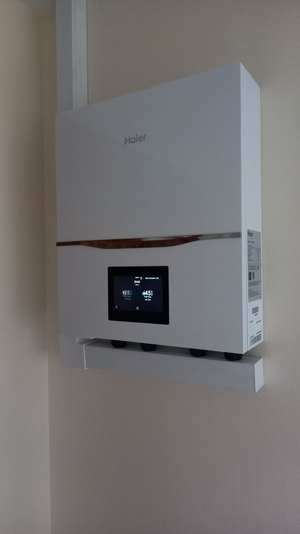

It's alive 😀
I actually got it switched on yesterday, but I was going around in circles until I realised that the diverter valve must be the wrong orientation. I'd also need to re-read how to enable and set up weather compensation. So I switched it off and rotated the diverter this morning and set up the weather comp and schedules for heating the DHW during the cheap rate.

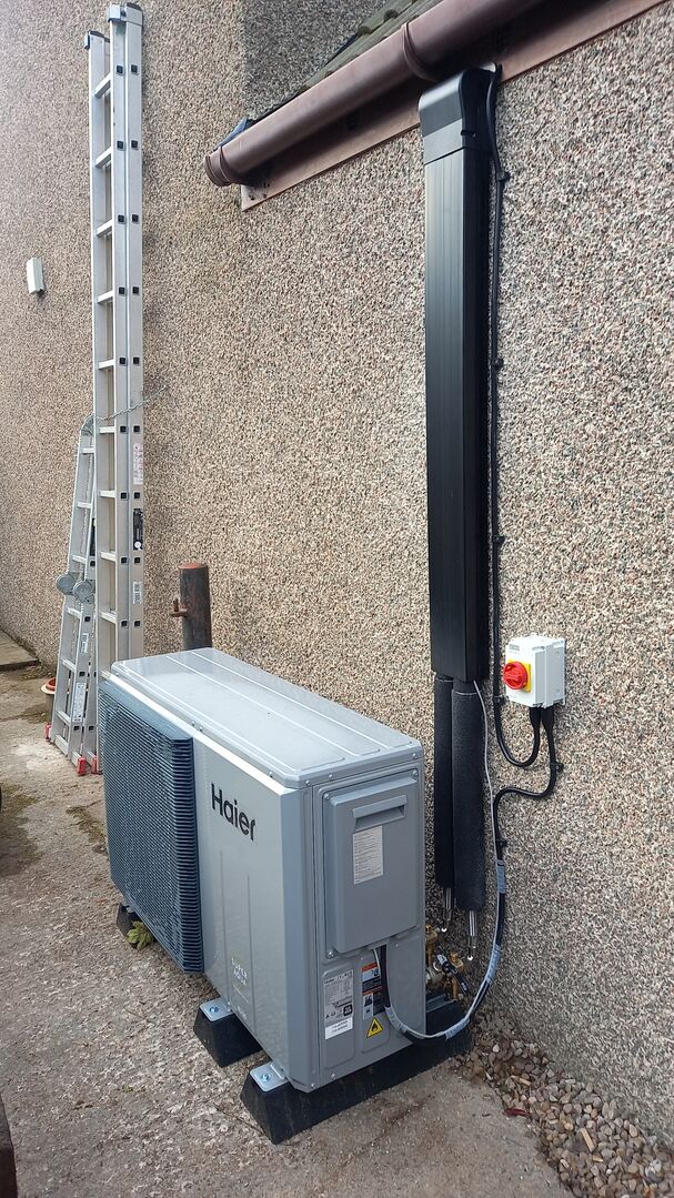

Apart from sealing the external Primary Pro joints and fitting another meter of insulation to one of the primaries in the loft, I'm finished.

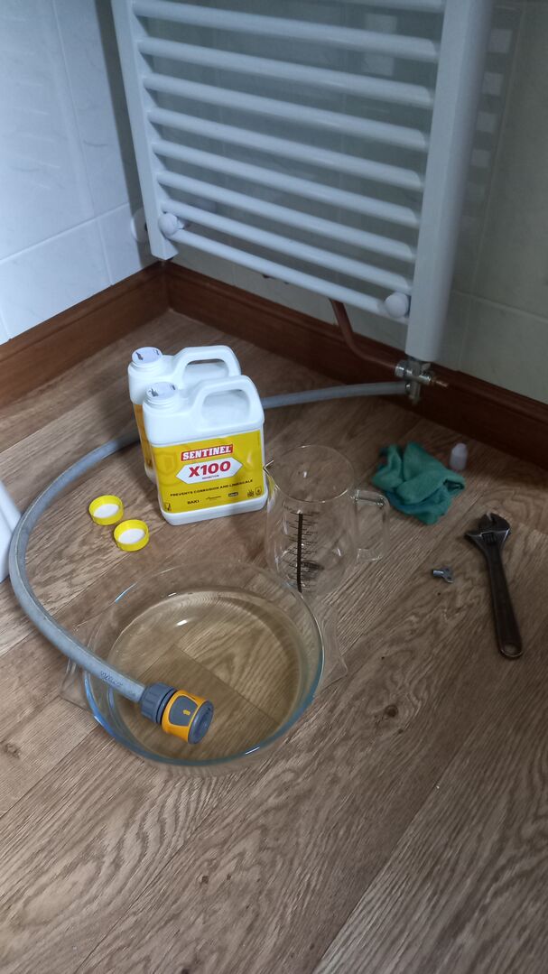

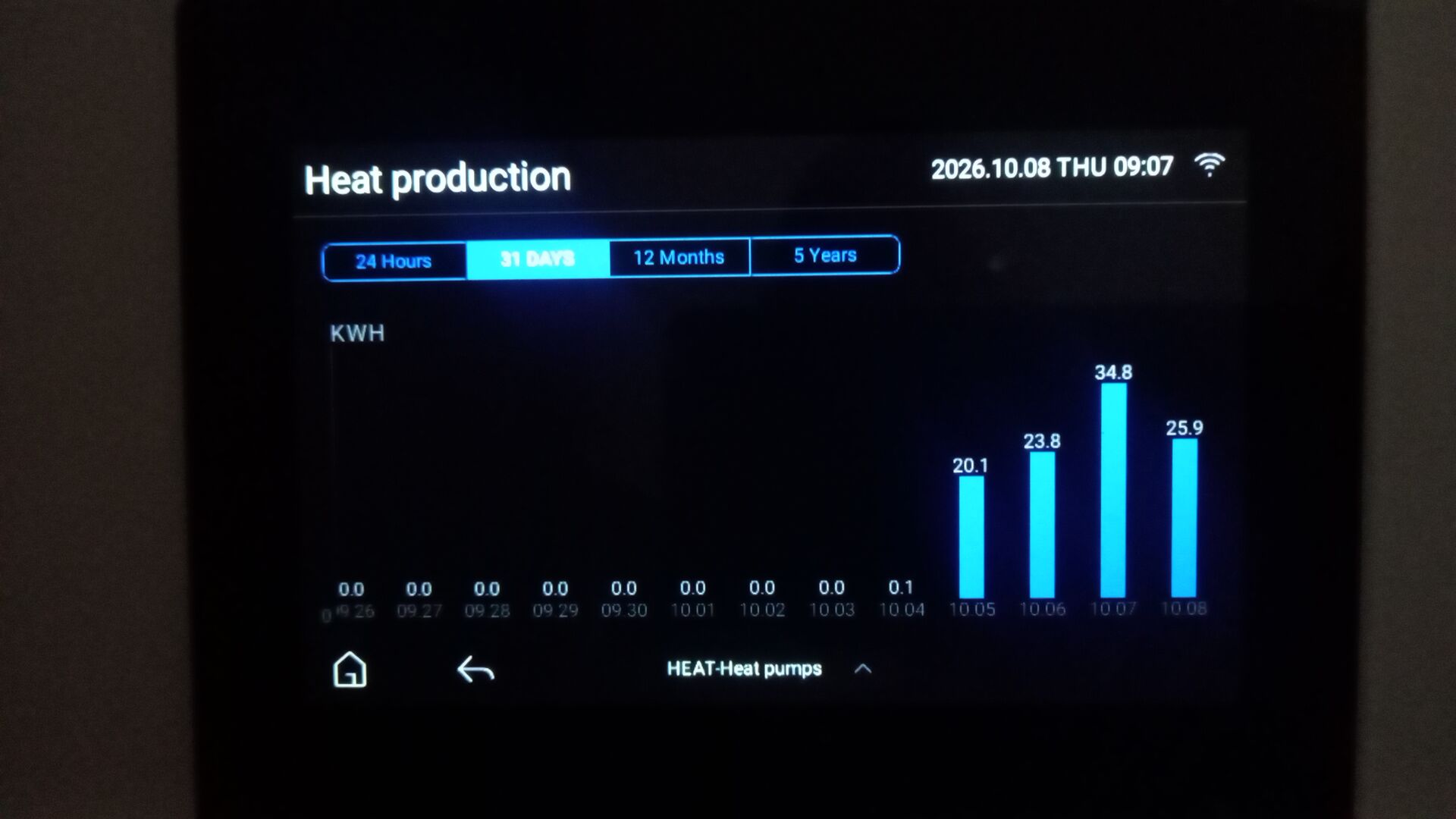

Having flushed the system and finally connected up the last secondary branch with no leaks apparent after bleeding and the pump running for an hour, it was straight forward to add inhibitor into the top of the towel rail. Shut off both inlet and outlets. Open drain valve and then open bleed valve to let some air in. Drain off two and a bit litres and close the drain valve. Remove the bleed valve fitting and add the inhibitor. Refit the bleed valve fitting and re-open the inlet and return. Bleed off the air and tidy up.
20261008 090749
20261008 090731

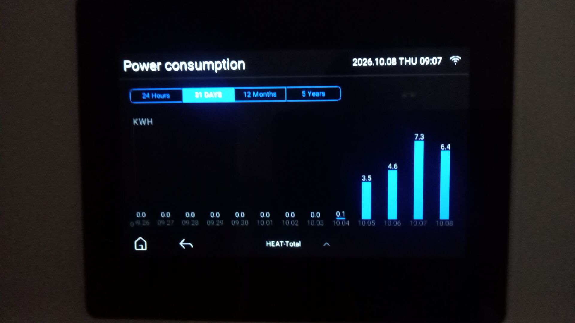

As well the outside air temp getting down to 3° yesterday morning, flushing the system with cold water and also having to loft hatches open, probably accounts for yesterdays higher readings. Plus there's the three additional radiators connected.
My actual electricity usage isn't really any different to what it was prior to switching over to the heat pump! However it was only the living room which was heated to 20° in the afternoon and evening. Now the living room is 20° all the time, along with the bathroom and WC. Kitchen hallway and spare bedroom are all 19°.
It's rather underwhelming, because it's just nice and comfortable.
