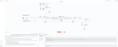

@marvinator80 Two of the best resources on Youtube that I have found recently are Cole Medin and Nate Herk. N8N is a great tool once you get your head around it, I also recommend learning Docker (if you don’t already use it). I have been learning by failing for a few months lol. I use their tutorials build the example agents then deconstruct them to try to get them to actually work for me.
This is an example of one it looks scary but when you look at its constituent parts it is pretty logical. I also use Cole’s Archon to build AI Agents which get me about 80% of the way then I have to fettle them.
Image 13 05 2025 at 09.53
