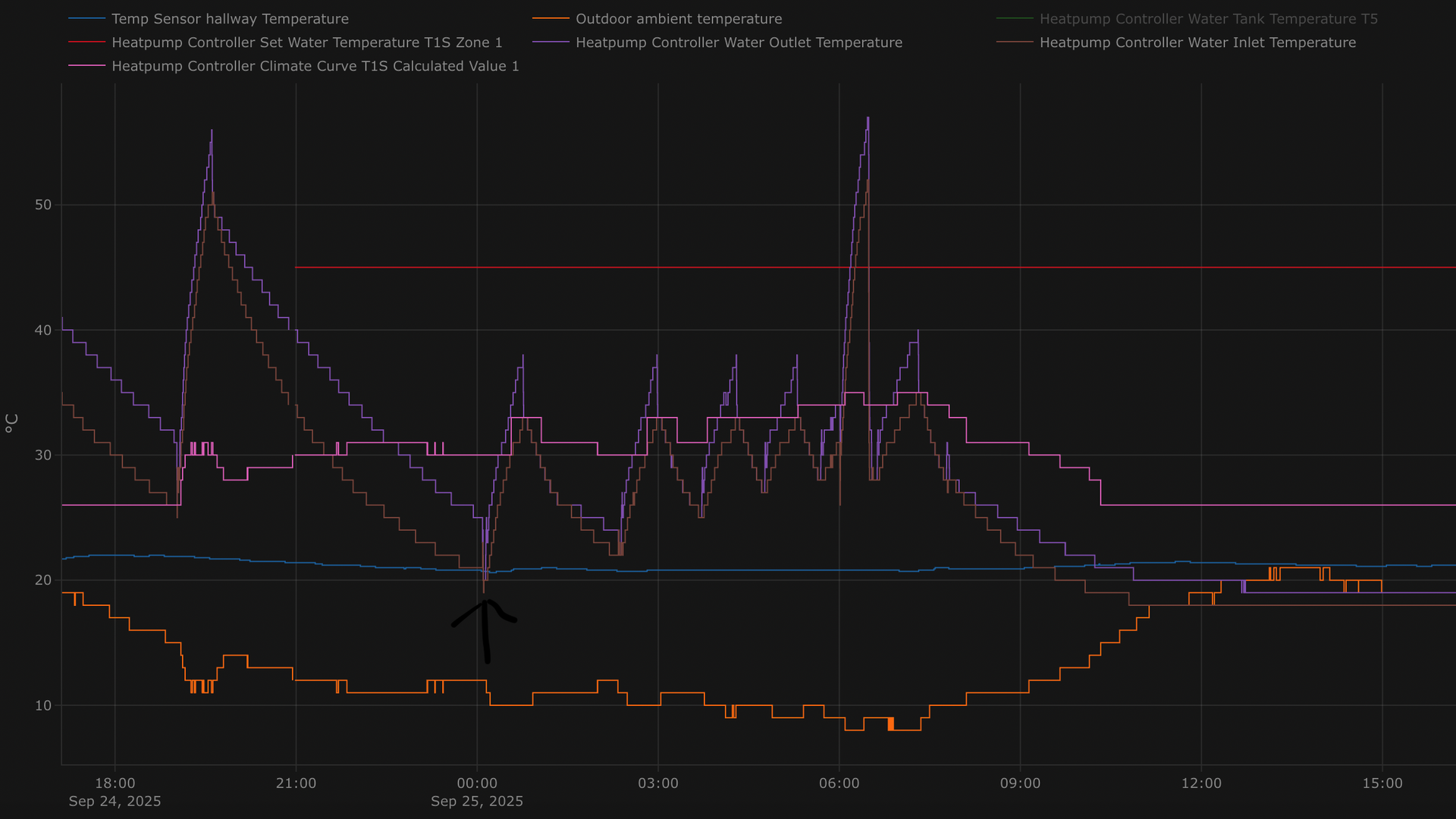

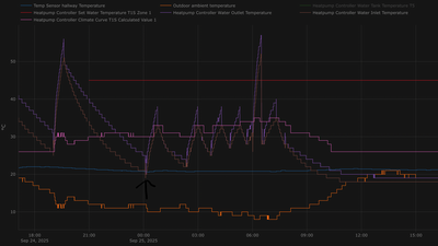

A few more observations. Generally over the last few days it's been a case of heating kicking in overnight to keep the house at around 21, and then off during the day as the house will be perfectly warm enough due to warmer OAT + solar gain. I've now got one simple automation for the heating to come on if the hallway temp sensor drops below 20.8, and one to turn off at 21.5. This is only really to mitigate for the fact as above that we don't need anything during day once sun comes out, so when a bit colder I don't really anticipate using these and it will just be on all the time.
Snip20250925 16
Black arrow indicates when temperature has just dipped below 20.8 overnight.

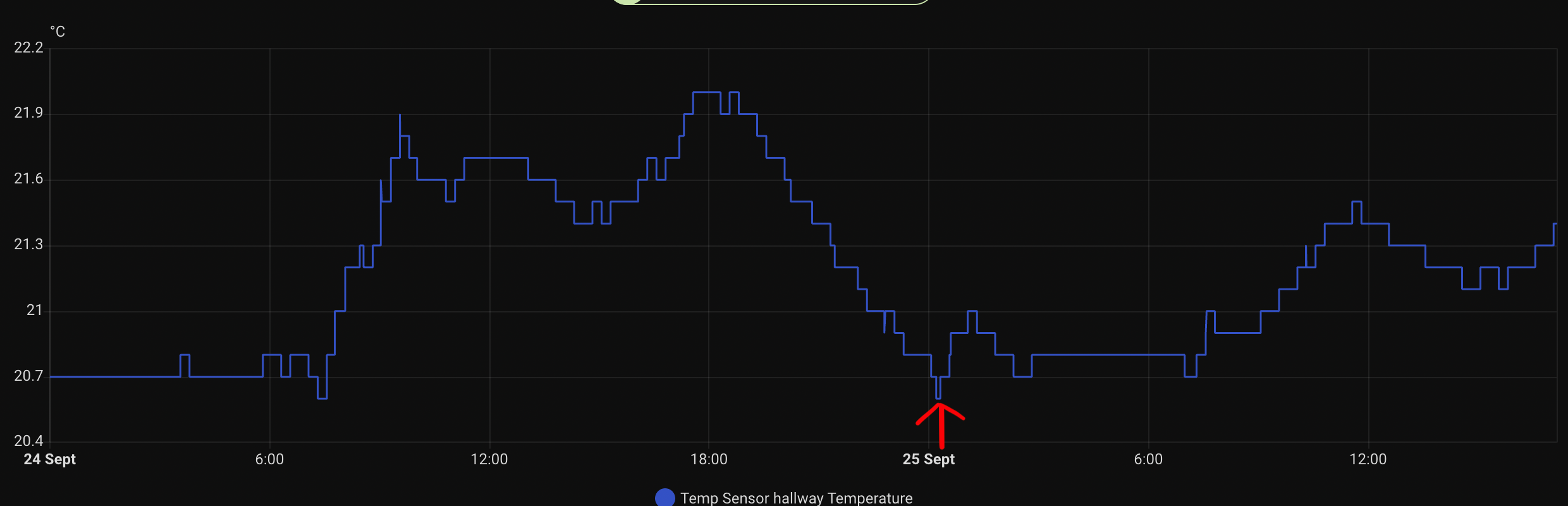

More detailed graph of IAT, red arrow indicating when automation has kicked in. This has then kept the temperature nice and steady overnight up until 0800 when the OAT has increased and solar gain has heated the house. Therefore the WC curve settings seem about right now.
Snip20250925 17
One annoyance- I have realised that any automations that alter the serviceman settings (such as WC curve) turn everything off, just as it would if you access the serviceman settings on the physical control panel. This is such an annoying design feature with the midea!

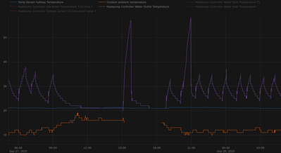

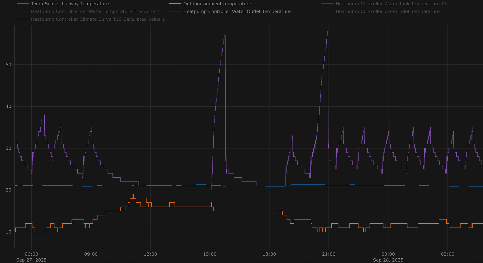

That said, I am managing to keep my house very close to 21 just from the set curve with no adjustments. So far, so good (not sure what has caused the missing data for a small period for OAT).
Snip20250928 18
Using the overshoot and undershoot adjustments are a little complicated though as I'd then need to set another automation to reset it back to standard curve settings within certain temperature parameters. For example, I could have one overshoot adjustment to kick in at 21.5 to lower the curve a little. Another at 20.8 to increase slightly. Between 21 and 21.3 to revert back to standard set curve perhaps....
