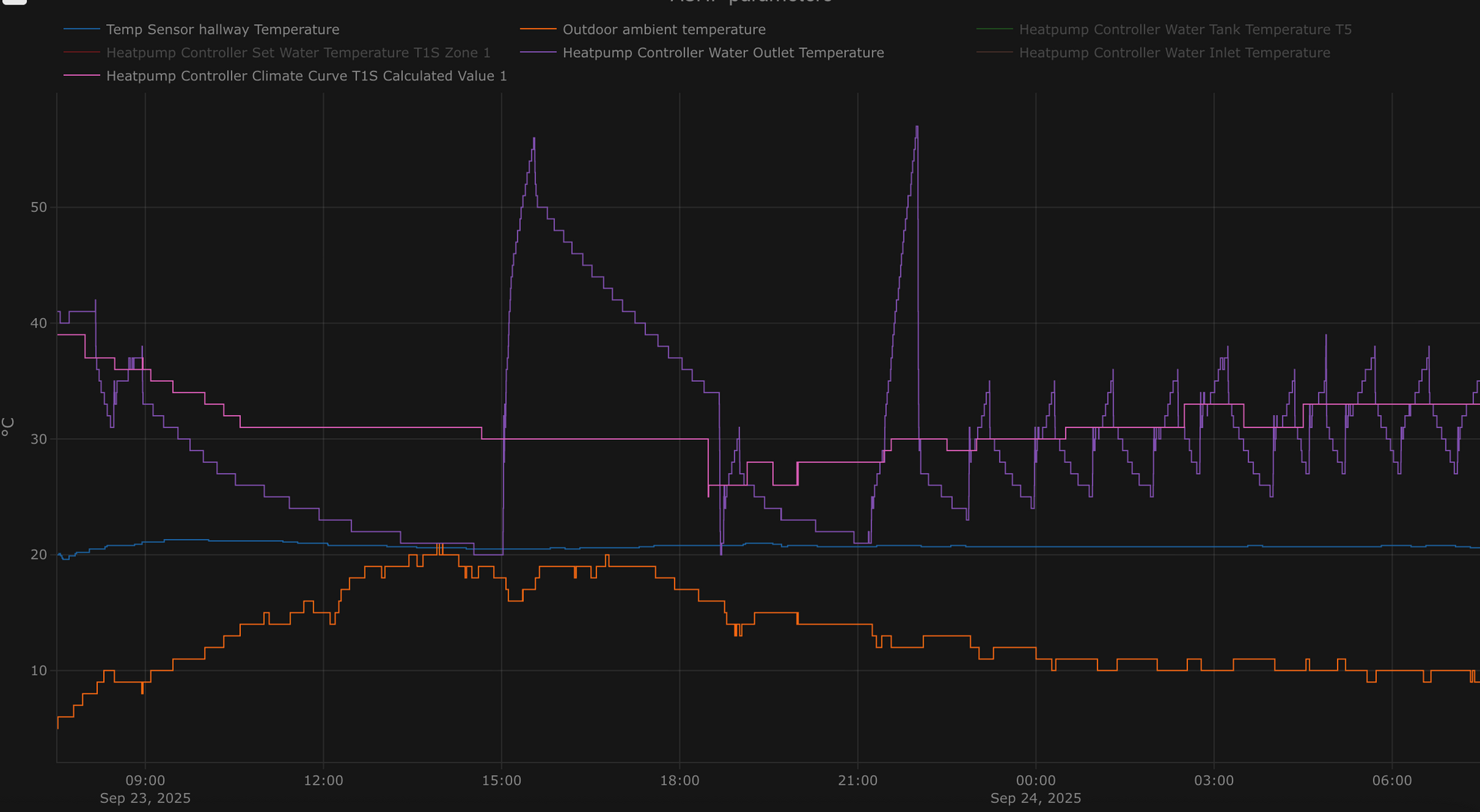

There is something terribly wrong with the control of LWT. Where do the peaks come from?
I presume you mean the big >50 degree peaks: almost certainly DHW heating. Note the set LWT hasn't increased, those peaks happened outside the main space heating control logic. They may be timed, or manually started.

@jamespa yes that's exactly what I assumed it was rather than anything being wrong. As per previous graphs I've posted the actual LWT fluctuates around the set LWT. I can get whole house electricity consumption from my tesla app. This doesn't seem to show me that much of interest though to be honest. Just steady peaks and troughs throughout the night, and reasonable consumption overall.

Oh right...didn't realise Tasos might have meant the large peaks. Those are for my DHW as Cathoderay says.

Seems obvious to me unless Im missing something, and the big peaks are presumably DHW.

Think I may be getting somewhere. The lowest permissable outlet flow temp on the Clivet unit is 25, so I have dialled this down to 26 at 15 OAT.

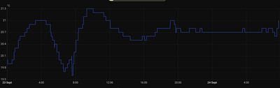

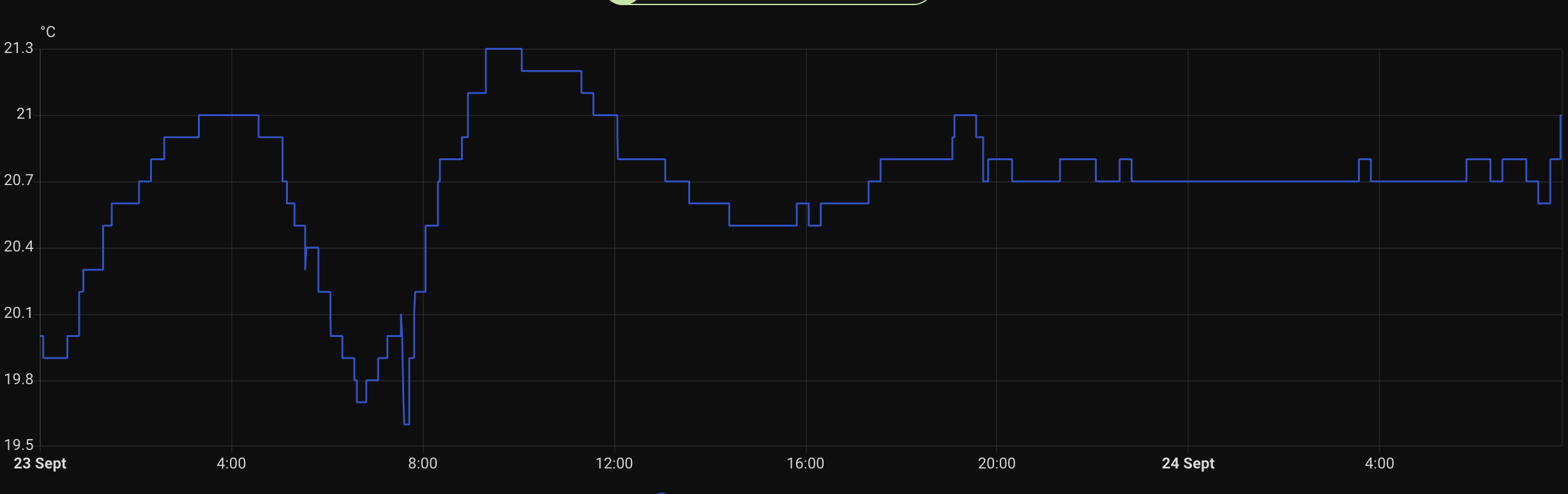

Close up of IAT, so I changed the parameters at around 2000hrs, and it's been much more steady with less peaks and troughs.

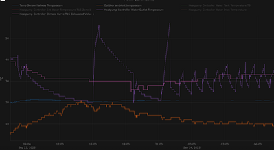

I think you need to be careful with axis scales. The lower chart is what some might call a gee-whizz chart of part of the upper chart. Both show the same IAT data, but tell a different story, until you look at the Y axis scale, when it becomes clear the lower one has been 'tweaked' such that the apparent variation is much magnified. In reality, the IAT was in a narrow range, between 19.6 and 21.3 degrees, and spent about half the time at or very close to 20.7 degrees.
Going back to the upper chart (which is a semi-gee whizz chart, Y axis doesn't start at zero) , I don't see anything too strange there. OAT goes up then down and stabilises at around 10 degrees. For some reason (I have picked up on this before on my charts) the controller seems to increase the set LWT during this period of stable OAT, or maybe the OAT change is just enough to trigger the set LWT changes.
What I am less clear on is how the automations (quasi room stats) ate interacting with the WC. The right half of the chart looks like classic WC in mild conditions, the heat pump is slow cycling to reduce output, with the mean actual LWT at about 30-31 degrees, perhaps a bit lower than it should be at 10 degrees OAT, but what matters is the IAT is stable at around 21 degrees. What's happening on the left hand side is less clear. Had the automations turned off the heating?
Is there any way you can add the automation activity to the chart? Presumably at any point in time it has a state, say 0 for off, 1 for on, can you add that to the chart? I do think running both WC and tight room temp control at the same time might be over-egging the pudding. Really the best option is just WC (plus or minus several hour deliberate setbacks if wnated, but they are best left out of the equation until the WC is properly set up), with gradual tweaking of the WC settings to get it just so. Even then there will be variations, eg from solar gain and wind chill, but they are best dealt with by using some form of 'load' or 'demand' control or compensation ie auto-adapt depending on IAT (which is not the same as crude thermostat control).
I think I am right in saying your primary concern was getting the set (and actual) LWT right at warmer OATs. If so, the best primary way to do this is through the WCC settings.
