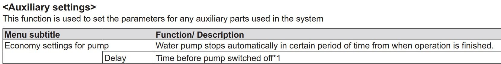

This isn't an exact reply to your question, as I don't have the same hardware as you, however if you want the primary/circulation pump to stop shortly (/immediately) after the compressor stops, on my FTC6 settings I'd adjust the following (see image - 'water pump' isn't that helpful here, it's not pump 4 that overruns, it's 1 & 2, and perhaps 3 if you've two zones) - I don't know if zero is allowed but the default is 10 mins overrun (and note the manual's commentary on the effect of reducing the time); without knowing what 'distortion in the buffer tank' means, I'd probably avoid zero if you can help it, if only to dissipate a bit of recently-generated heat [away from the outdoor unit]...
