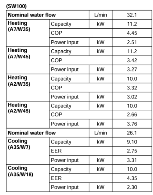

You should be able to find a databook for your model that provides information on the recommended flow rates.  I did a quick search and found a service manual that stated a nominal flow rate, but the unit should operate within a range.  The nominal rate shown was 32.1l/min which suggests yours might be at the low end of the range.  I found my relevant databook within Mitsubishi's site, but had to search for installer data rather than customer data to find it, but hopefully this gives you a start point.

I've been experimenting with different flow rates at present, but that's with a view to seeing if it has any impact on efficiency to improve COP.  Results are inconclusive at present and I'm experimenting within the databook tolerances for my specific heat pump.
