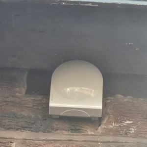

Could you post a picture and model number of the Halo. The standard one is designed for boilers not heat pumps, I thought they did a heat pump specific one but now Im not so sure. If it is designed for boilers it may not be helping

Posted by: @tinkestral-6@jamespa I've posted a picture of tank
er no picture, please post picture of tank and halo.

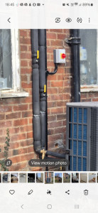

Hello, please can you post some pictures of the pipework as it comes out of the back of the heat pump, up the wall and into your house. It looks as though there's not much insulation on the pipework.

That insulation doesn't very good to me, maybe others can comment.
The last picture is different to one of the earlier ones. There seems to be a paving slab under the heat pump in one of the photos, have the installers been back to modify the system? Is the insulation still installed?
Bob
No but the plumbers put the slab there. The plumbers are coming back out as the insulation guys are saying pipes need to be moved.
