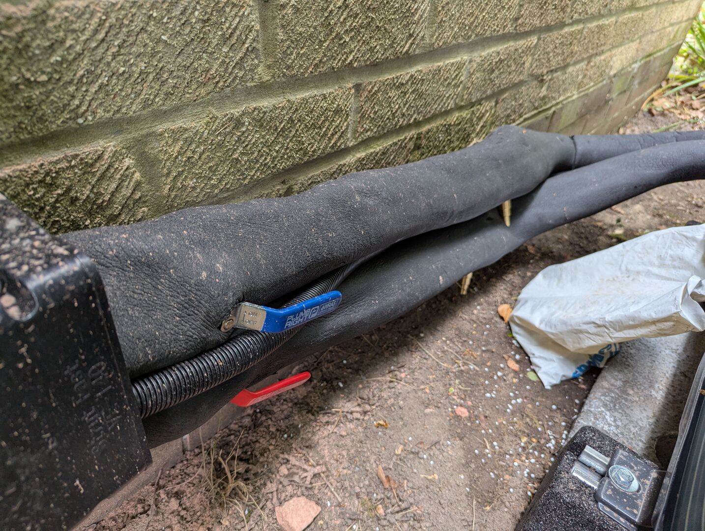

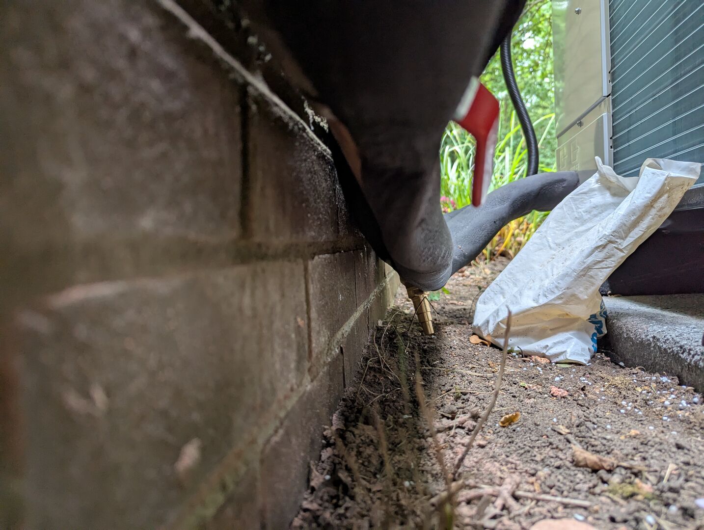

@old_scientist I took a closer look behind the pump this morning. As I'd expected, there are two anti-freeze valves (as least I think that's what they are) which are deliberately exposed, along with the red and blue isolator valve 'things' (official technical term!) further along.
It might not look the neatest in the photo, but it's not a section of pipework that can be completely enclosed due to various "sticky outy bits" (another official technical term!) and I'm quite relaxed that any heat inefficiencies in the work are likely to be minimal.
Personally, the biggest eyesore in the photo is the gravel bag, which has been left temporarily for someone to return to and use to top up the heatsink when they're next in the area. I could have removed it for the photos but have left as is, for which I believe the official technical term is 'lazy' on my part.
Posted by: @sheriff-fatman@old_scientist I took a closer look behind the pump this morning. As I'd expected, there are two anti-freeze valves (as least I think that's what they are) which are deliberately exposed, along with the red and blue isolator valve 'things' (official technical term!) further along.
Anitfreeze valves, or at least the ends of antifreeze valves, should be exposed, the idea is that if the heating isnt on when the OAT approaches freezing, they get cold and open
Personally I think there is logic in leaving the shutoff valves exposed also, if you need to shut them off in a hurry you don't want to be fiddling around removing insulation, nor do you want the handles to be hot. Others, Im sure, will disagree.
That outside pipework would concern me. Surely rigid sections accommodating the valves, and then properly supported with brackets? The rest inside looks ok but I would not be happy with that and personally I'd be getting them back.
Speaking from some experience of dealing with some highly suspect plumbing that we have inherited in our current house, the pipework that seems to be most prone to leaking is unsupported pipework carrying hot water.
Great that they got it done in two days but that part at least has been rushed.
