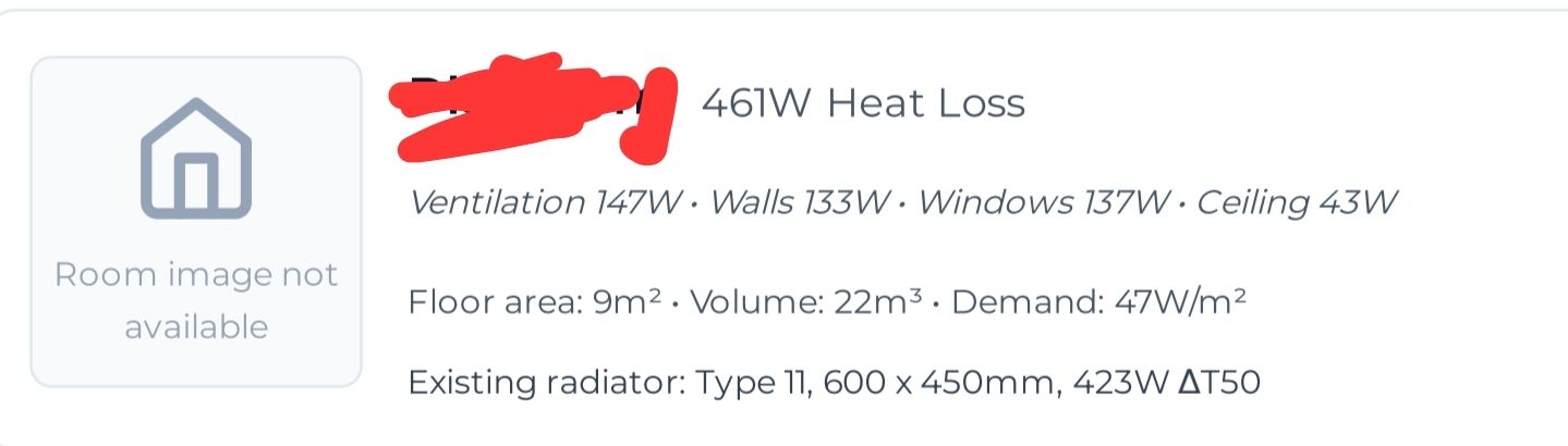

  1. @jamespa attaching info of the room in question. Heat loss 461w, existing radiator output at delta T50 423W. This room should need a new radiator under every circumstance
Screenshot 20260929 084926 My Files

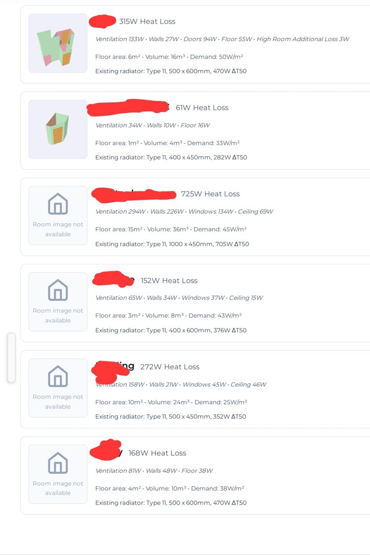

Adding some more info on the other rooms
Screenshot 20261006 195839 My Files

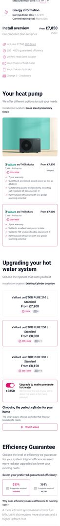

Posts: 16
Screenshot 20260909 093332 Chrome

All noted.  There are a few observations worth making here.
  • A 140sq m 2004 house should not have a loss anything like as high as 6.4kW.  I suspect heat Geek know that and may have taken it into account in their design, but are constrained by the MCS calculations in what they write down, hence the guarantee approach
  • Looking at the first room you posted the ventilation loss assumes ACH = 1 approx which is an outdated over estimate.  ACH=0.5 for habitable rooms and ACH = 0 for non habitable rooms are the more recent assumptions.  I haven't checked the other rooms you posted
  • In a sense a SCOP guarantee which, SOFAIK, only Heat Geek give, is much better than a figure for the FT.  You dont ask (and are not very interested in) how hot your car engine runs, you ask how many mpg (or mpkWh) it does!
  • Heat Geek do have a good reputation.  I suspect, but dont know, that they are using accumulated actual data from previous installations to 'calibrate' survey results, which are inevitably whatiffery and have a high degree of uncertainty in reality even though they look scientific,  I also suspect they are playing a bit of a numbers game with this, know that perhaps 1 in 10 will require a rad upgrade or two that they haven't directly costed for, but have built that into their pricing on average.  This is, I admit, pure supposition but consistent with their approach of guaranteeing SCOP (which is what matters to you) not FT (which sort of doesn't).
Nevertheless the mismatches are a concern and questions should be asked and answers received in writing.
