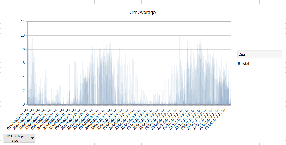

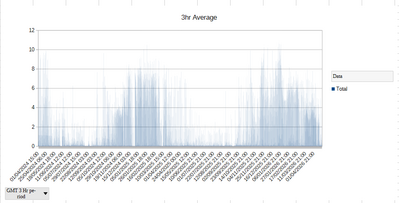

We are with Octopus Energy for gas as well so I can pull the 30 mins data. I am not sure how far back I can go, but I am attaching 2yrs. Curious about what it says.. The last year is with the current insulation..

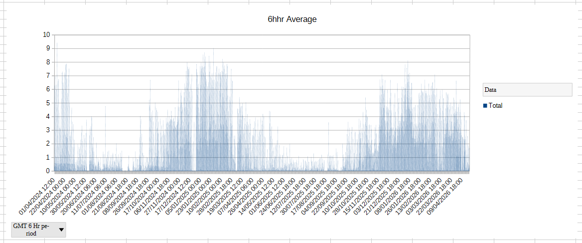

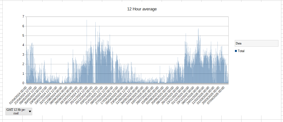

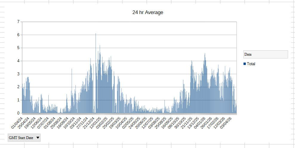

Hopefully you can read this. The various tabs in the xlsx show average power over 3, 6, 12, 24 hrs. If you can get average temp or degree days for your location you can plot vs one of these which will give you more info. The pictures are the plots from your data which appear in the spreadsheet.
The file 'Measured consumption - Copy' is my data for comparison.
Posted by: @jamespaHopefully you can read this. The various tabs in the xlsx show average power over 3, 6, 12, 24 hrs. If you can get average temp or degree days for your location you can plot vs one of these which will give you more info. The pictures are the plots from your data which appear in the spreadsheet.
Thanks, I think most of the 10kW peaks at the 3hr graph are since we have the boiler on setback overnight, which is followed by a surge in the early hours. We would not have such a low setback with an ASHP. But there are a few cold days where power used is above 7kW for more several 3 hour periods.

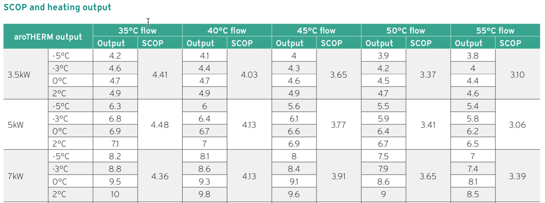

From the below table of Vaillant heat pumps, if the external temperature is -3C, a 5kW boiler would deliver 6.8kw at a 35C flow. Tempting to get a simple 5kW, but perhaps we need a 7kW pump?
The first pre survey quote we can actually consider calculated a 7.1kW @ -2C and used a 45C Flow Temp at -2C
Posted by: @batpredFrom the below table of Vaillant heat pumps, if the external temperature is -3C, a 5kW boiler would deliver 6.8kw at a 35C flow. Tempting to get a simple 5kW, but perhaps we need a 7kW pump?
You need to make an allowance for defrost, perhaps 10-20%.
That said I would also be tempted to go with the 5kW based on this data. Before coming to a conclusion I would definitely plot 24 hr consumption vs degree days/average OAT and work out for myself what I would do on coldest days if it turns out to be undersized, and whether I am truly happy with that. Otherwise I would go with 7kW which you anyway may not get a choice over because I think you might struggle to convince an installer.

So our heat loss survey came up at 5.1kW on the coldest -2C day. The installer surveyor is still recommending the 7kW Arotherm. I had a look at https://energy-stats.uk/heat-pump-cycling/, the lower modulating would is seen as 2.2 for the 5kW vs 3.2 for the 7kW. Anyway, the 5kW could help bring the outlay below the budget ceiling...
