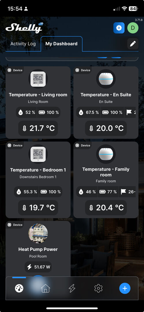

@morgan No they are not controllers. They are just monitoring temperatures in various rooms in the house, to give me more idea where the Mitsu Remote Controller is best located. They give a more meaningful reading than the Tado smart radiator valves.
It is made more difficult because it is an upside down house and the two main rooms downstairs (including master bedroom) are both North facing and poorly insulated, so if I locate the controller in the South facing living room upstairs, (the room you most want stable comfortable temperatures), the downstairs will be cold.
With Set temp as 22C and wireless controller reading 20.5C this is what I have right now:
IMG E9EB3DE0BC1D 1
