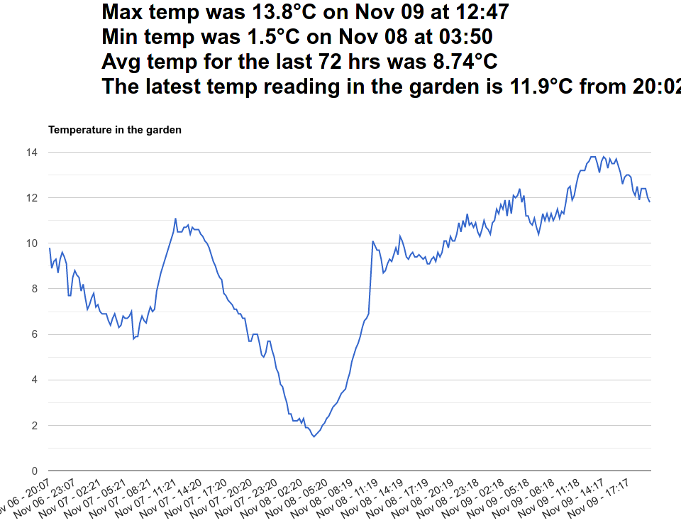

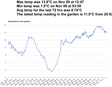

This is the outside temperature in my garden for the past 72 hrs (@derek-m it's passably accurate, AFAIK)
garden temps 06 11 to 09 11

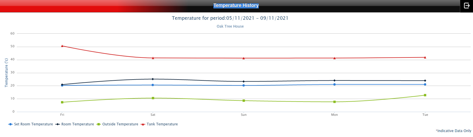

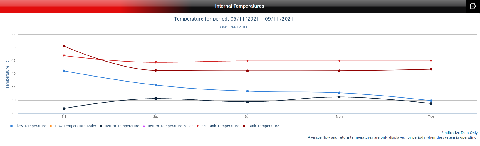

This is the Temperature History from the MelCloud web page
Temps 05 11 to 09 11

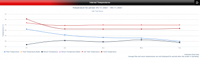

and these are the Internal Flow temperatures from MelCloud
Int Temp 05 11 to 09 11
You can clearly see the room temperature line stabilise as I switch over to Weather Compensation at 4:30pm on Saturday 6th...!

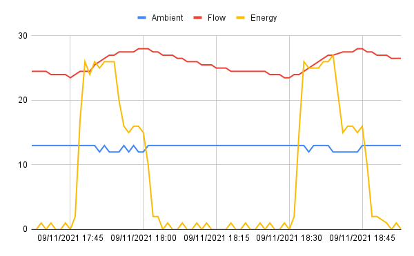

Update. No change in settings and house is still a pleasant 21.5C.  To remind you, the weather compensation is a baseline 45C flow at -3C and 20C flow at 18C. I've moved it down 2 so that makes it 43C flow at -3C and 18C flow at 18C.

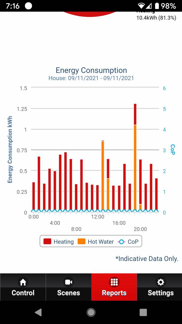

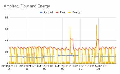

091121Energy
091121Graph
Energy used 9/11/21 was 10.4kWh.   You can see the ASHP has settled down to a steady cycle every 40 minutes or so. The high peaks are the DHW kicking in.
I'm not getting carried away as it's quite mild out but that's definitely a so far so good from me.

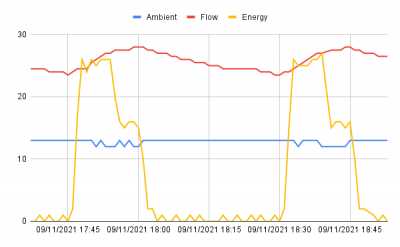

For those interested, here is a closer look at the energy used.  Each cycle is remarkably consistent, with an initial peak and a smaller plateau then a drop to near zero. The data points the monitoring sends each have marker; stop, heating, hot water,  etc.  At the data points at the peaks, the marker says heating but at the plateaus, it's stop. I assume parts of the system are still going but others aren't?  The peaks are about 1.6kW. and the plateaus 0.9kW.  Any ideas?
091121Graph2

Melcloud (Mitsubishi's own cloud based system) to collect the data.  The phone screenshot comes direct from the Melcloud app.  The others are from a csv file downloaded from Melcloud into Google sheets.
