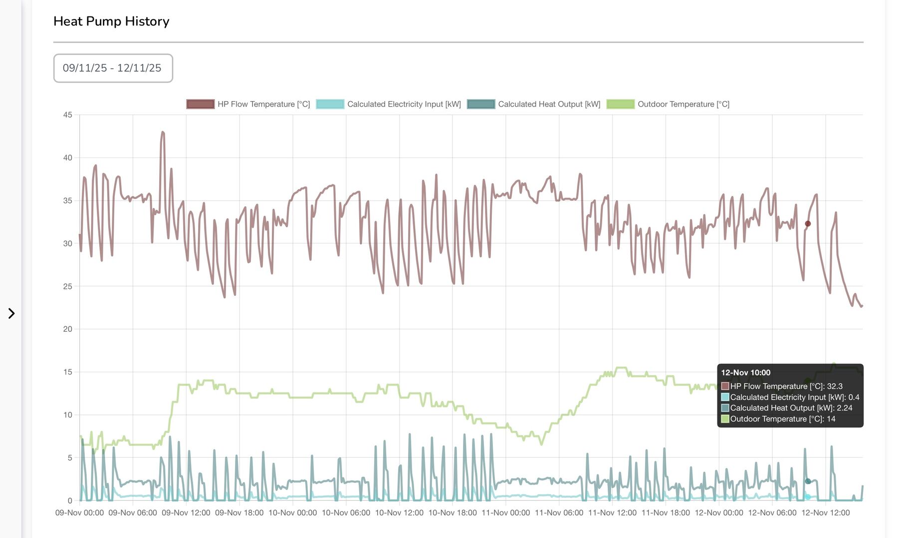

And here is what the Homely plots say for the last few days. The key indicates the parameters measured. Regards, Toodles.

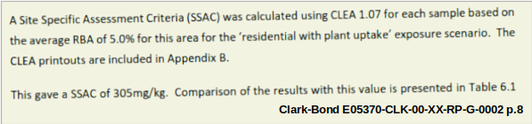

For example, if a house-builder wants to develop an area of land which is contaminated with Arsenic, the Planning Authority might have a maximum threshold of 140mg/Kg.
That's 140-milligrams of arsenic salts within 1Kg of soil.
The geotechnical survey reveals much higher concentrations, which means that the land is unsuitable for housing.
So the geotechnical consultants (working on behalf of the developer) analyse the types of arsenic compounds which are present,
and declare that only a proportion of these are capable of 'biological uptake'.
That's called a Site Specific Assessment Criteria (SSAC) which is invariably lower than the threshold.
Here's an example of such an argument being put forward in planning documents:
In short, the term 'site-specific conditions' means that a mathematical fudge-factor is being used.
In your case, the Installer needs to substantiate what site-specific factors are being being used in the calculation.
I would expect this to be an explanation similar that I've just quoted for the arsenic above (ie a fudge)

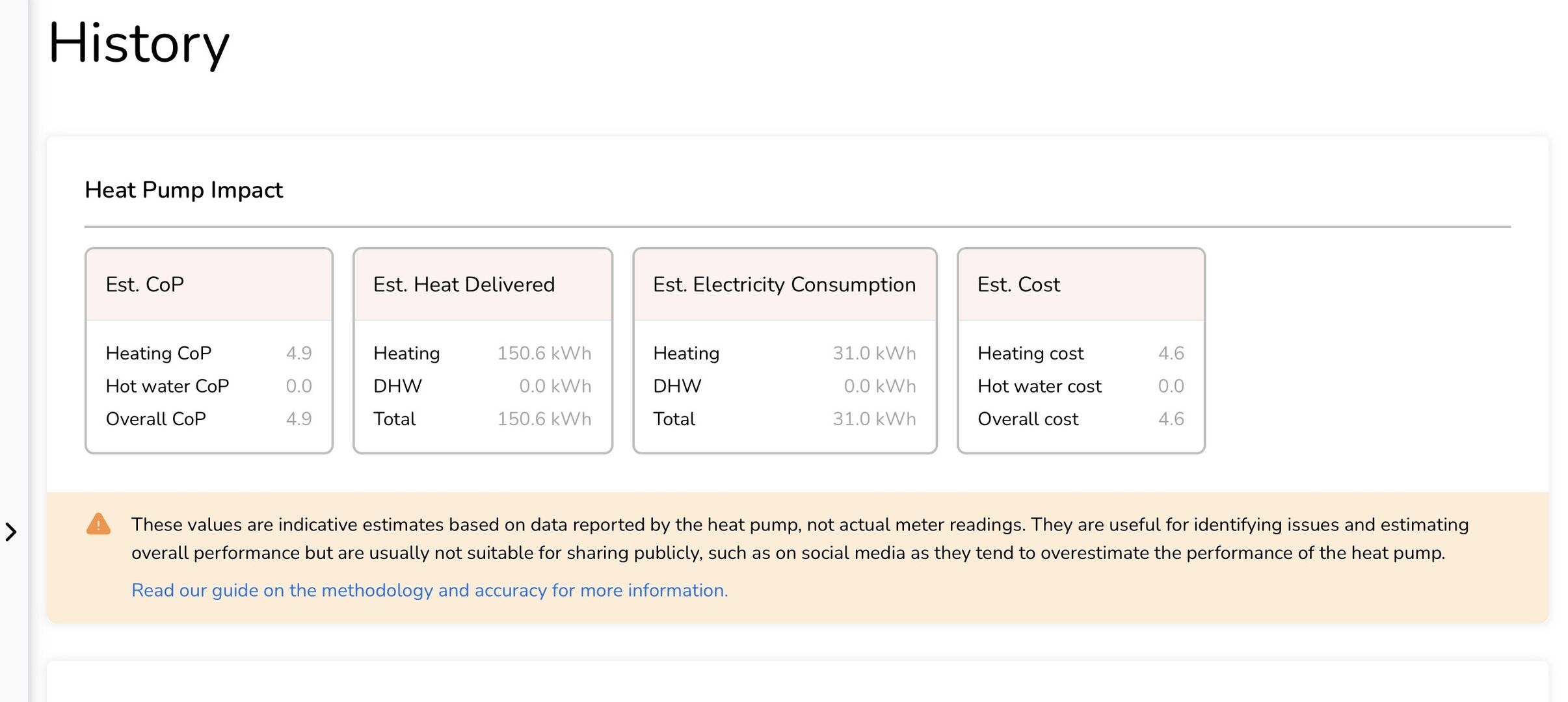

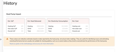

@toodles yes I am relying on the Daikin data from the MMI, and have heard before that they are less than reliable. The video you shared gives a really clear explanation, and I can see on looking at my app that all the figures are rounded to the nearest whole number! This whole episode started when I was considering 3rd party controls and monitoring and looking at my documentation - once the current questions are resolved I will hopefully go back to that. I liked the sound of Havenwise as there is no hardware installation involved, but the downside of that is that they are then relying on the Daikin data. I believe they are currently in consultation with Daikin to develop a Daikin compatible system, it will be interesting to see the outcome of that.
@mairia Yes, reliance on the Daikin MMI and thence the Onecta app does suggest Chinese Whispers are involved. Having said that, the data that Homely Connect shows does appear to have less rounding involved and does display totals of less than integer granularity. You will see in the Homely plot that they do state that the calculations may not be very accurate! On a typical day, I will see that Onecta thinks I have consumed 1 kWh over two hours but the Homely will plot this as perhaps ~600 Watt hours over that same period. I suspect that Havenwise may have to use the same source information unless there is an external energy monitoring device to supply the data. There may be a reader of this thread who can advise on this? Regards, Toodles.
@jamespa again really useful, thank you so much. Temperatures tomorrow are forecast for 5-6 degrees during the day, 8 degrees the day after so I'll look at COP over a few hours. At the moment my app shows outside temp 6, water temp 37 and the lounge is a comfortable 20.8. At the end of the day if a poorer COP is the price to be paid for keeping the house at the temperature I'm comfortable with then I don't mind accepting that. And definitely want it to be warm enough on very cold days. But maybe the air vents in the garage should be blocked! I don't think there's any way for me to see if the unit is cycling - any record I've seen of that on the Daikin users FB group is from 3rd party software.
