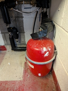

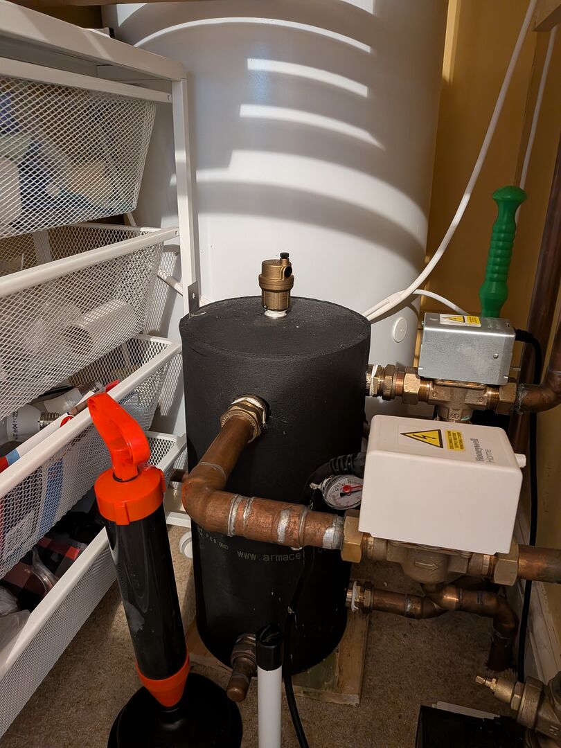

I think the answer to your third question is yes, but I'm not confident. I've attached some photos - the first is in the garage (attached to the heat pump) and the second is in the airing cupboard.
PXL 20251228 150253801
PXL 20251228 150156740

The black cylinder in the second photo looks like an llh.  Is there a water pump nearby and how many pipes feed it?

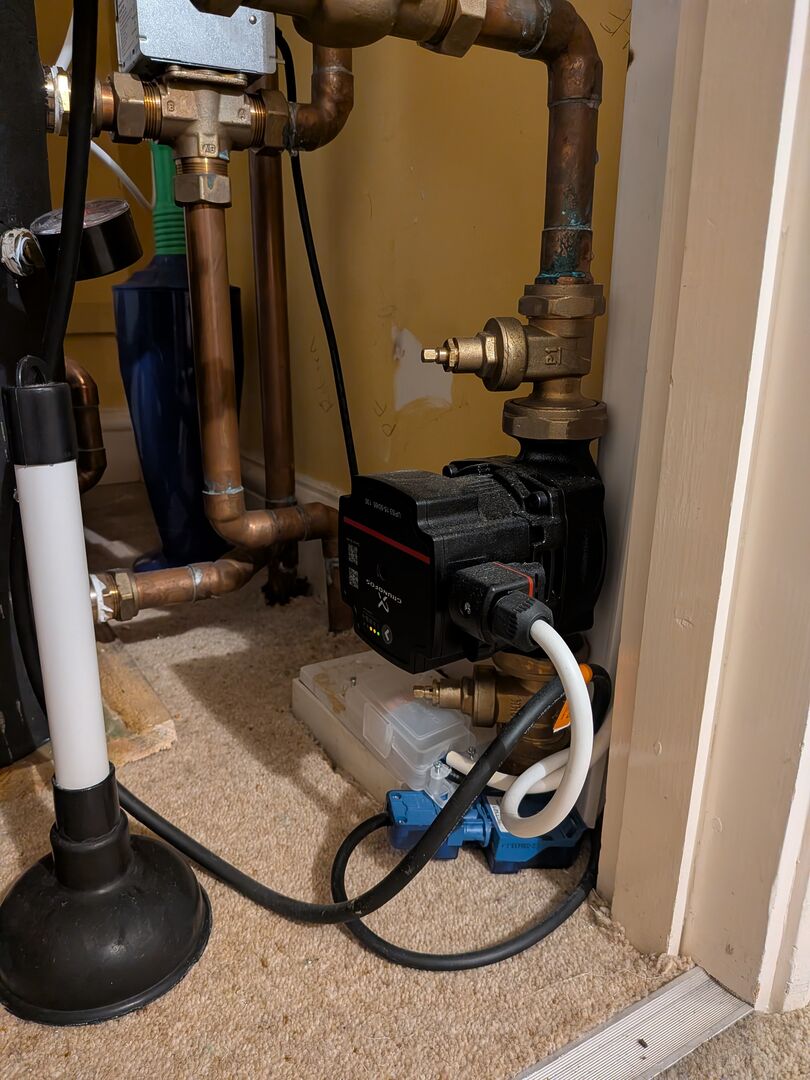

Sorry missed your question re: water pump, have attached a photo.
PXL 20251228 162801500

Ok looks like you have an llh which makes fault diagnosis more difficult unfortunately, but doesn't affect the need to do the thermostat test and conclusions it will hopefully lead to.
