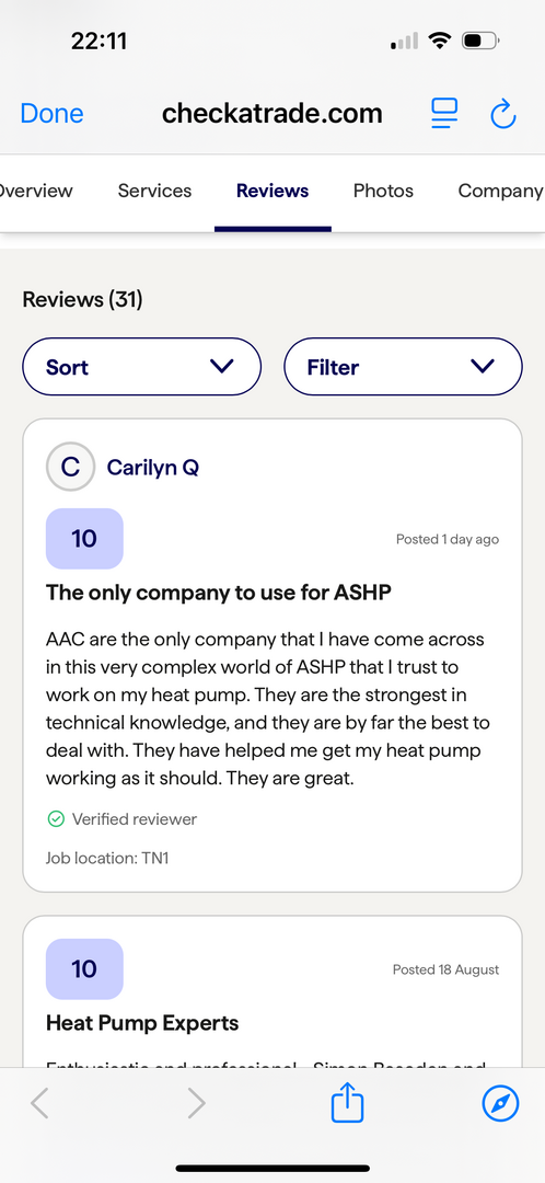

Another result and another very happy service customer: Clients 1.4 yr old initial incorrect installation, months of negotiation, multiple visits by original installer and failed to resolve, final word from original installer is user error and customer reaches out to us 14 months after installation, explains to me whats happening at which point I decide they have a case for us to intervene and we go in anonymously to investigate and repair in 1 day. We do not look to judge others but just to provide a service, diagnosis and repair if possible, we do about 1 of these a month. The installation has never worked and our discovery found that it never would have. These errors were corrected and the customer is happy they had the service, diagnostic and modification done.
I have offered this client the link to this community to seek support for further actions they would like to take against the initial installer and I explained there is a wealth of knowledge here for people who have gone through the same kind of issues, I trust you will all help if they choose to contact the community. We as a company cannot help further or advise further as it is better that we support this client with the system and looking after it for now.
They left a very nice review for which we are grateful.
