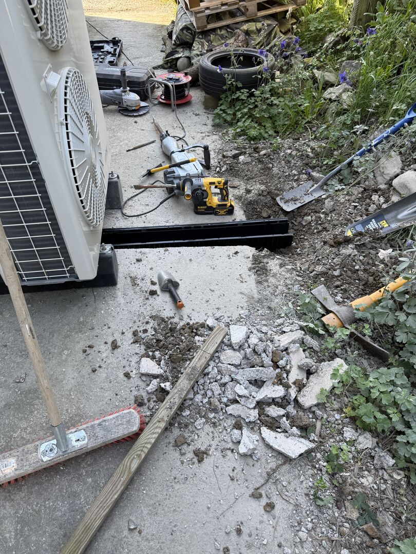

@uk_pete_2000 Yeah we get massive solar gain on half of our house but as soon as the wind changes it wicks away the warmth like no ones business, the trials and tribulations of living on a cliff top in Wales! I want to be able to eventually get to where the system predicts what it needs and just works and in order to do that I need to understand as much of the system as possible, which is why I started down this rabbit hole!
All that said I would also like a diverter valve that actually diverts properly, pipework that doesn’t leak, and to not have to put my waders on every time I walk past the damn thing! At least the last one I can do something about!

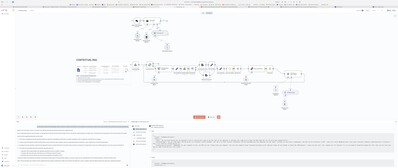

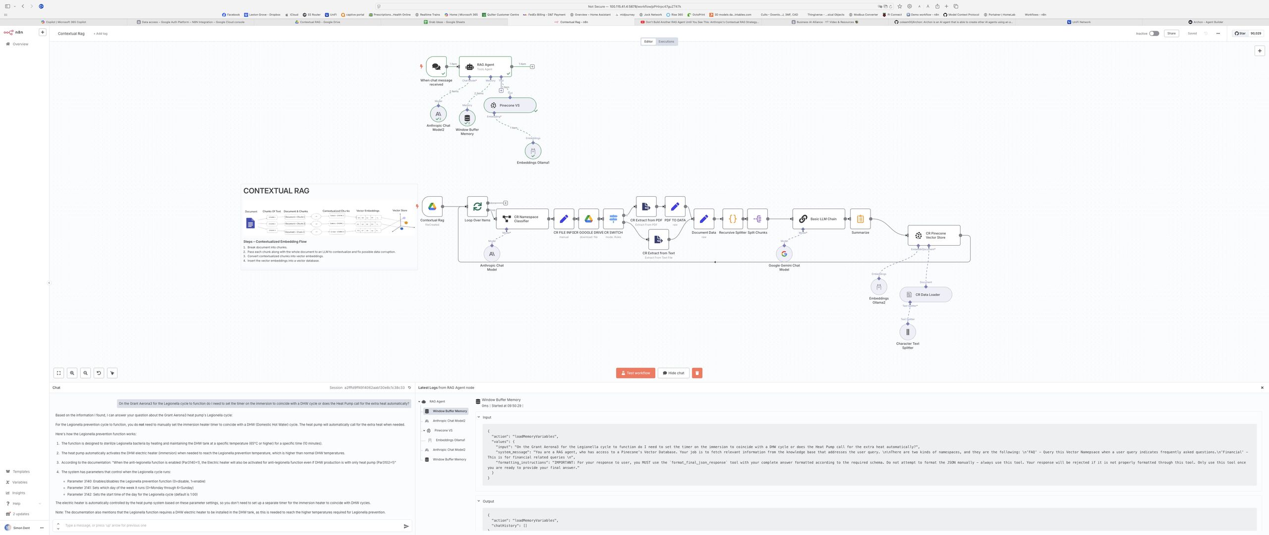

And I also did a thing!!!!! In my quest to learn all the things I have created an AI agent that I will be adding to, that can search all things Chofu/Aerona3, ASHP, automation thermodynamics, space lasers and store that information with added context so it makes retrieval much better. I really have gone down a rabbit hole!!!!!

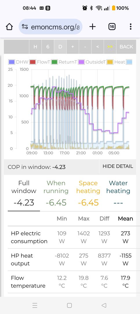

Cycling is a normal activity of heat pumps and boilers. As long as it's not short cycling (1 to 2 minutes or less on off cycling) ideally it will cycling is about 3 or 4 time an hour or less, that is how they operate when below the minimum modulation.
The long run time is the heat pump slowly pushing heat into the floor. The cycling is the heat pump just topping up the energy in floor, basically applying just the right amount of energy to keep stable. WC just adds more or less energy based on heat loss to outside.
Your running costs will decrease if you embrace what the heat pump does normally. Basically the heat pump does a bit of work has a rest, your making it run a marathon each day, which is fine if you are a time if use tariff. If not WC wins every day.
I am currently cooling but the same rules apply. This is my last 24 hrs, just read in reverse to apply to heating. The purple line is outside temp and the spikes are the heat pump running. As it gets cooler the heat pump has less work to do so the cycling gets wider, heating is the opposite.
Screenshot 2025 05 13 08 44 05 64 40deb401b9ffe8e1df2f1cc5ba480b12
I think you have missed the point on weather compensation. It is about having a stable house temperature, that's it. If you aren't getting that, some fine tuning may be required. You have to change flow temperature as it's the only mechanism to change energy output from a radiator or UFH system as once installed you cannot change the area. WC just changes the flow temperature in line with the energy likely to be lost on lower temps outside.
