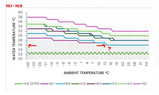

I found the Aurora/AdlerCastra user Manual. Page 4 concerns me, the WC curves are stepped as a function of OAT not smooth and the steps are, in some cases, quite large.
I also found a user manual, which looks different and might be a newer version perhaps?
I think the WC "curves"/steps are the same in each doc, though the graphs/scales make them look different. Either way it looks like the steps are 1 degree each. Is that unusual? Could it be just the way they've chosen to display it? I haven't actually seen how any other WC curves look!

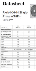

Thank you for the research! It looks like Panasonic does a claimed 3kW as well? But I think that could well be the 5kW derated too..
The give-away is physical dimension and refrigerant charge (given usually in kg).  If both are the same then its almost certainly software limited.   Confirmation, if you can find the data, is in the capacity data tables if these contain minimum output as well as maximum, which only some publish.
I cant actually find the Panasonic specs, but here is a snip from the Riello showing  that the 4kW unit and the 6kW unit are very likely the same hardware
Yes as you say 1 degree per step, so probably OK.  I don't however understand why the 'floor' temperature is so high, normally you would start off with the floor being perhaps 27-30C at OAT20, this seems a bit half-hearted.

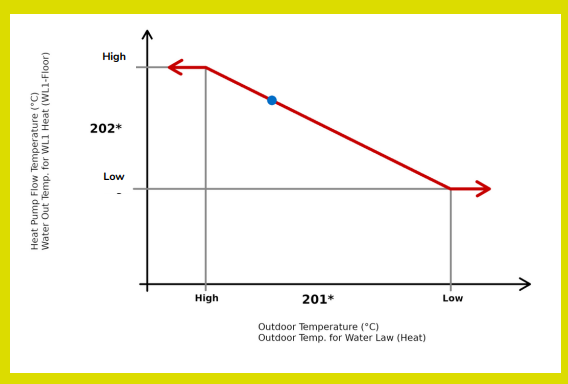

There are two principal 'types' of WC curve - those with a set of fixed curves which you can switch between with a single parameter - eg Vaillant
and those where you have to program two OAT-FT pairs on a straight line (or sometimes even more than 2 pairs)
Both are normally represented as continuous, but of course they may in fact be discreet.
Having looked again at the Aurora manual my main concern is now the high 'floor' temperature for the curves that are likely to apply to radiators, which does not appear to be adjustable.
If I understand what you mean by floor temp, and if I'm reading this correctly, it looks like the lowest the Aurora can go is 26C on the lowest two curves? The app can be used to automate switching between different curves btw, if it's a concern that the other curves don't go that low? 😮

If I understand what you mean by floor temp, and if I'm reading this correctly, it looks like the lowest the Aurora can go is 26C on the lowest two curves? The app can be used to switch between different curves btw, if it's a concern that the other curves don't go that low? 😮
Yes, but the need to switch will happen on most days in the shoulder season and a fair number in the high season, so in practice you will almost certainly end up controlling on thermostat unless you automate it.  That might not be so bad but will impact efficiency.
Goodness only knows why they have done this - I suppose its to ensure that radiators always feel hot (and thus avoid call outs) - but its a silly thing to do really!

@morganr I have been thinking some more about those WC curves.  Fundamentally they are, so far as I can see, just wrong.  If your aim is to run on pure WC or very close, Im far from convinced that you will be able to do so unless you override them more or less completely.
I could be wrong, but I simply cant see how the FT at say 16C (and certainly at 20C) should be anything other than pretty close to the desired room temp, for the simple reason you need hardly any heating at this point.  And that puts the slope out - its not just a floor that only affects higher OATs, its a wrong slope which will also affect medium OATs.
My conclusion is that it must be intended that these pumps are controlled by a thermostat/temperature sensor not run open loop on WC.  Whether that matters to you only you can say.  With a max FT of 38 there may not be a massive efficiency loss operating it this way, but there will be some penalty.
I repeat that I may be wrong, but personally speaking I would be somewhat doubtful about this machine, albeit only for this reason (and of course the support concern).

IF this is anything to go by in "medium" OATs.. it seems like the HP will simply need to be off all day when the OAT is around 16C.
But maybe that just pushes the problem (if there is a problem like you suspect) further down the temperature scale. Even if it's off at 16, we might want it on at 14, but much lower than the curves appear to go (the lowest FT I've seen is 24C). Curiously though, the pump can run in cooling mode (which they have separate cooling curves for), so surely it CAN go lower..?
One other interesting thing is the curve labelled "HL8 (DYN)", which is apparently dynamic, but I've not found anything in the docs explaining it/how to use it. On the Dutch "Tweakers" forum (where quite a few enthusiasts have Adlar units), somebody mentioned it's still in development. But if it'll be a fully dynamic curve, that might be the solution! I'll ask Adlar about that. 🙂

Houses with reasonably low loss aren't going to require heating once it gets above say 15C because you have a constant 400-600W going into them from waste heat from electricals and the people.  Obviously this waste heat causes a problem when the oat goes higher still because it heats the house when you don't want it to.
The 'dyn' setting sounds interesting, possibly some form of auto adaption.  This adds to my feeling that this is a product very much 'still in development'.
