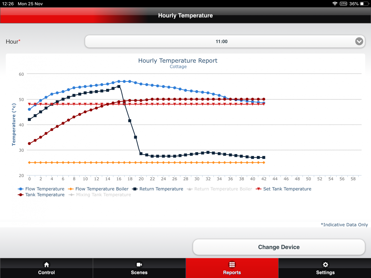

so I put the DHW on while the existing hw temperature was elevated. (To see how the HP would react when it reached DHW target temperature early in the cycle)
981D30C3 37F6 46DE BDA2 9ABE6DFA9BB4
Even though it has a pre-set (Max) duration of 43 minutes, it reached target temp in 32 minutes and switched itself into standby. ( the room temperature was 21c so it didn’t return to space heating)
 So on the Ecodan system it would appear that the system reacts to the set duration as a maximum duration if the target cylinder temperature is reached early.
