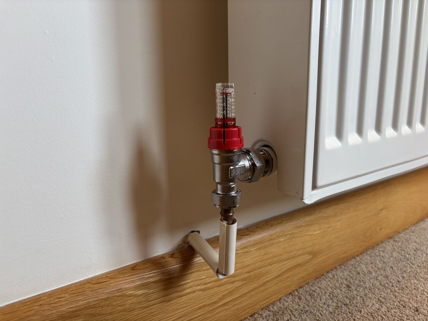

Day one is done.
The system’s been fully flushed and cleaned, and every lockshield has been swapped out for FRVs. They look fantastic and they’ve already exposed major flaws in our system (two in fact!).
This is shaping up to be an epic project and a huge learning experience. We’ve also filmed the first part of our video and we’re off to a flying start.

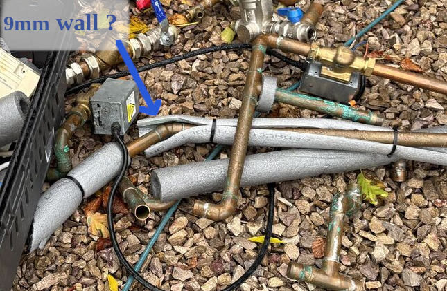

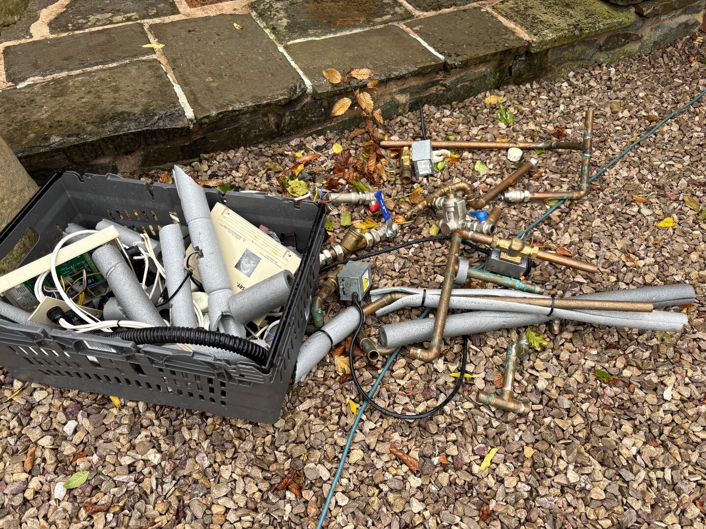

Day 2 was a beast. All the excess zoning, on/off stats and buffer related piping, plumbing and wiring is gone. Day 3 is about putting everything back to together as an open zone and balancing all our emitters. I'll make sure @heacol gets regular coffee throughout the day to help him power through.

There's a couple of motorised valves I can see there.
Put them on ebay, and you'll be able to cover the cost of Brendon's coffee for the duration.
How much insulation wall thickness is left, I wonder, after compressing it with nylon cable-ties?
