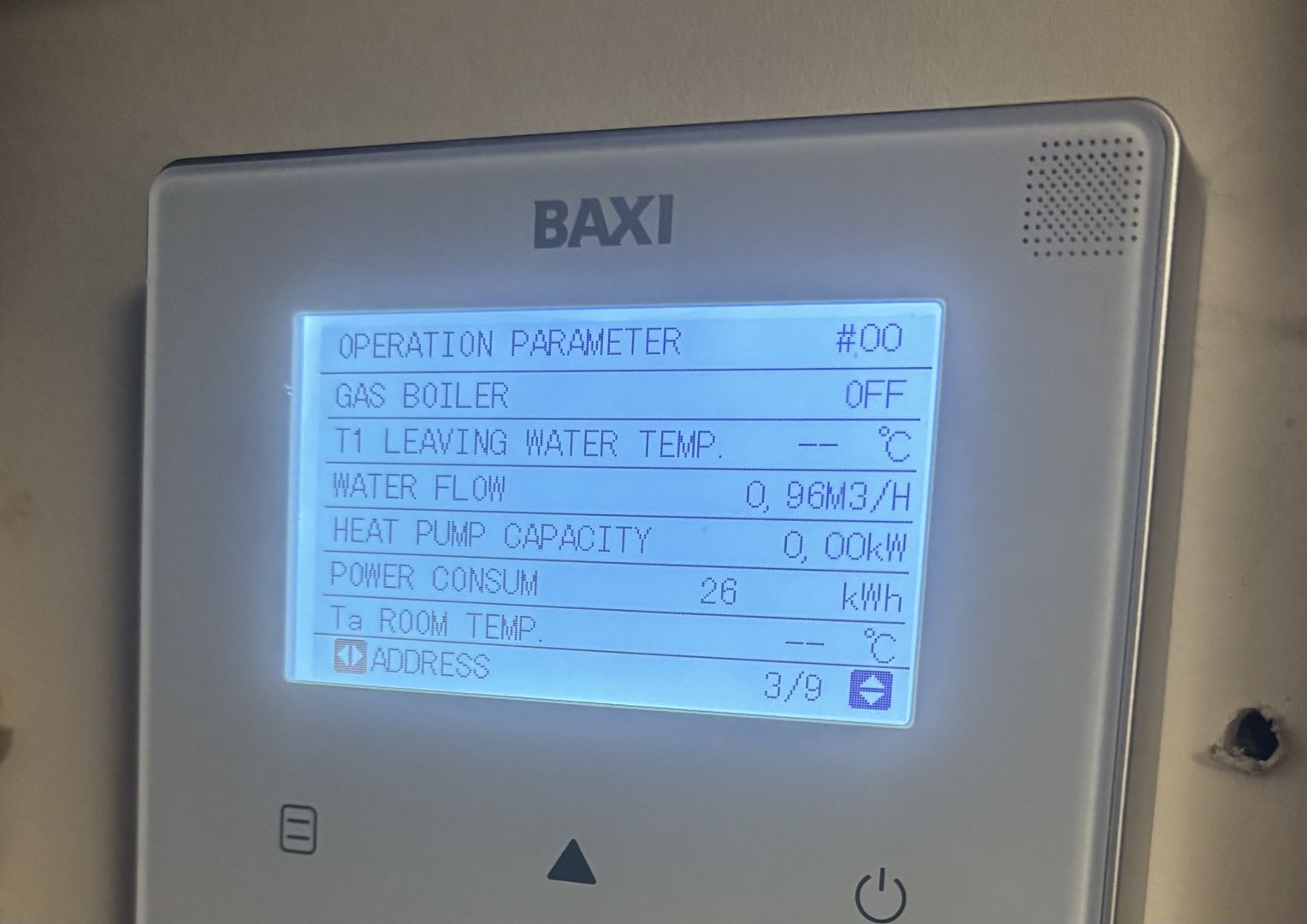

And @cathyem1 - those images - thanks - confirm it is. The listed parameters are identical to the ones I have on my Midea badged wired controller.
In the first image, the important parameters are the water flow, which is a bit on the low side (mine in normally around 1.4m^3/h), if yours goes much lower you may get flow errors, the heat pump capacity which is its current (instantaneous) power output which was zero at the time you took the photo, ie the heat pump is off, not producing any heat, and power consum which is unit's lifetime energy consumption (in kWh) which is currently low because the unit has only recently been installed (and has done very little since then). Bear in mind the power/energy numbers are Midea/Baxi numbers - they may or may not have been massaged (the evidence suggests if they are, it is by not very much). Ignore the Room temp line, its meaningless.

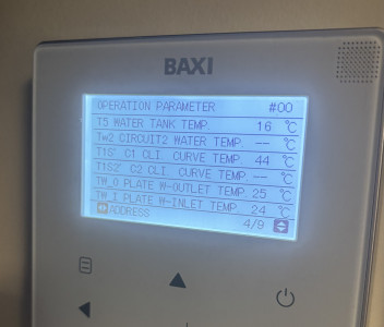

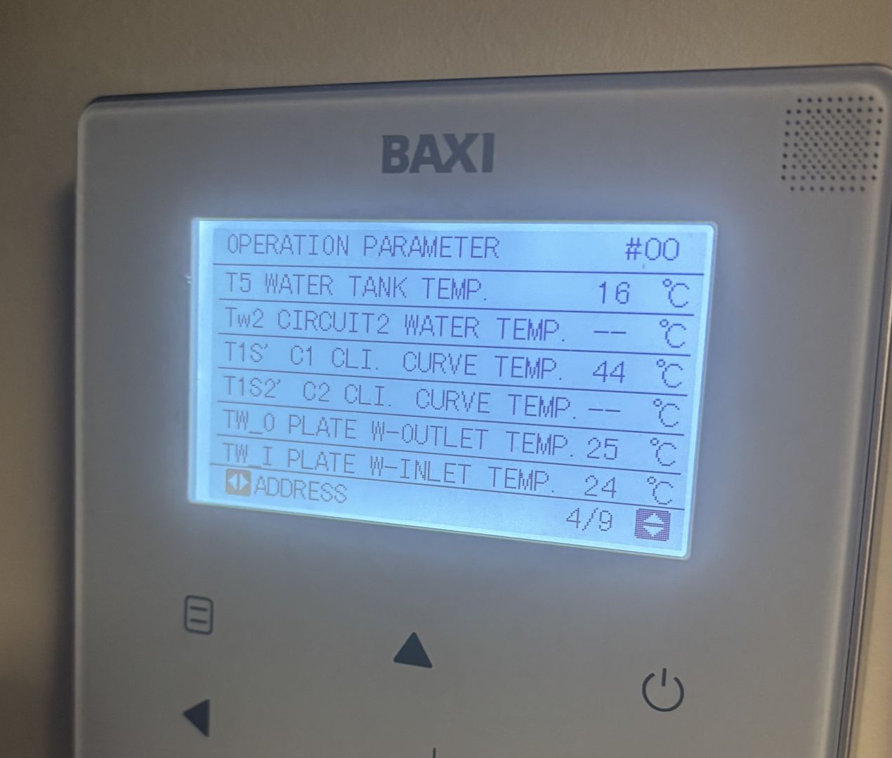

In the next image you have T5 which is the DHW tank water temperature which is low - either the DHW heating never comes on, or if it does, you have used up all the hot water. TW_O and TW_I are the all important LWT (leaving water temperature) and the RWT (returning water temperature) respectively. These are probably just above room temp, and are one degree apart, suggesting the heat pump may have run a short while ago.
I still think there is something to be said for waiting until your supplier visits in case he turns out to be excellent and takes you through everything. There is also a risk he may take exception to a third party (me!) meddling in what he sees as his installation before he has had a chance to set things up! That said, if there is anything you would like to try and set up before he arrives, we can certainly have a go. At the end of the day, it is now your heat pump, not your supplier's, he is just contracted to make it work properly.

@cathoderay Thank you for all your information. I don’t understand much of it, but I am keen to learn to make the system as efficient as possible.
I agree that waiting to see what the supplier says, how well he explains the system, and any tweaks he makes is essential. I will use the company for a service contract, so I don’t want to ruffle feathers unnecessarily. I will update you after his visit.
