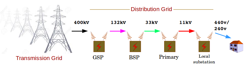

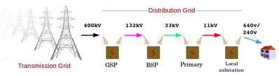

Present ToU tariffs are based on national supply and demand statistics.
But most of the new renewable sources of generation are connected at the EHV (33kV and 132kV) levels of the grid.
The electricity passes down from there to reach consumers across the 11kV level.
It doesn't go upwards to the 400kV National Transmission Grid.
DistrGrid
There is a need for ToU tariffs which better reflect the available capacity on the 11kV level,
which accounts for 90% of grid cable routes.
