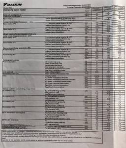

@marzipan71 I'm still struggling to get figures out of Daikan. It's mystifying to me that suppliers aren't more transparant as to the key performance parameters of their products. Do you know what the LWT is for those COP figures?

@wintergreen here's what I have - apologies if it's too small to read. I was left two sheets by the installers - with completely different COP figures for the same pieces of kit! First file has the figures I quoted above. Agree about difficulty getting data - I have no way of monitoring COP via my controller as other users are able to do with their kit.
