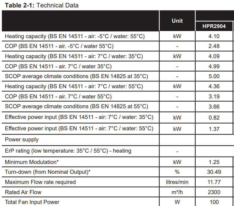

For the conventional approach, have you considered the 4kW Grant R290 heat pump? The specs say that it can modulate down to 1.25kW output (see image from tech data below), this seems a better fit for your house's 2.5kW heat loss than most 5-6kW heat pumps that can only modulate down to around 2kW.

Interesting, thanks, I'll now be asking my other two "quoting companies" can they supply this unit, I'd love to buy it myself and carry on using my unconvential system, but at over £2.5k i'd be a fool to not pay upto that above the £7.5k bus grant and get my whole system upgraded 🙁
