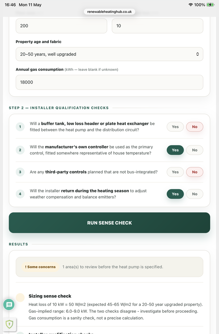

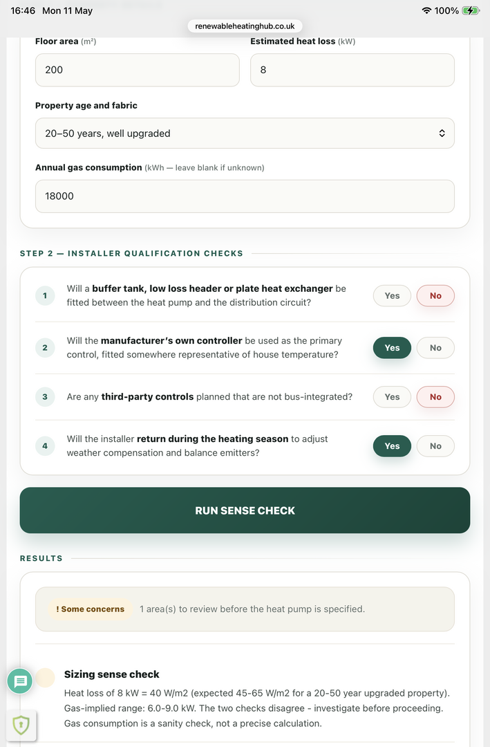

@editor in the spirit of helping out here. I ran the checks on our house, and it points to some inaccuracies in your sums(!) There’s two screenshots here, one our actual needed power, 8kW and one of the example quotes we had, 10kW. But the 8 should have showed as ok yet both show as a problem when the answer should be 6-9kW. Good luck finding it!.
@judith very helpful, thank you. I know the ranges are out and we're working on getting them accurate.

Another example. In this one the wording does not seem perfect.
Perhaps it was me but the annual gas consumption does not seem to to be used.
@judith it may well be not be used in the logic of the applet, but given it is referred to in the wording, it can mislead. If that is the case, easily fixed by placing that comment on a final sentence.
